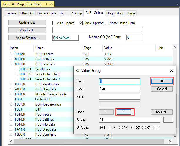

1. In addition, parallel use must be enabled via the "PSU Features" object in index 0x8001:01 "Parallel use".
Enabling parallel use
2. Select "PSU Features" 0x8001 in the CoE online tab.
3. Double-click on index 0x8001:01 "Parallel use". The "Set Value dialog" is opened.
4. In the "Set value dialog", select the value "1" in the field "BOOL" and confirm with "OK".
Parallel use 1:Fig.132: Enabling parallel use via "Parallel Use" 0x8001:01
