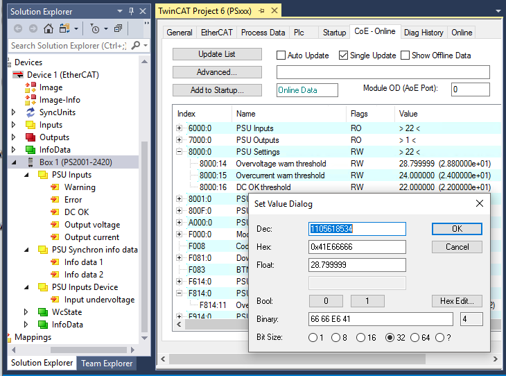

The warning thresholds are set in the CoE Online tab under 0x8000 and 0xF814 "PSU Settings":
Index
0x8000:14
Overvoltage warn threshold
0x8000:15
Overcurrent warn threshold
0x8000:16
DC OK threshold
0xF814:11
Overtemperature warn threshold
Setting the warning thresholds for the warning bit 2:Fig.122: Set values for warning thresholds e.g. 0x8000:14 "Overvoltage warn threshold" using the PS2001-2420-1001 as an example
1. Double-click on the corresponding warning threshold. The "Set Value Dialog" dialog box opens.
2. Enter the corresponding threshold value under "Float" and close the dialog box with "OK"
