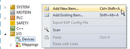

An EtherCAT device must first be created in an empty System Manager window.
OFFLINE configuration creation 1:Fig.71: Adding an EtherCAT device (TwinCAT 3)

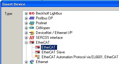

The "EtherCAT" type must be selected for an EtherCAT I/O application with EtherCAT slaves. "EtherCAT Automation Protocol via EL6601" must be selected for the previous Publisher/Subscriber service in combination with an EL6601/EL6614 terminal.
OFFLINE configuration creation 2:Fig.72: Selection EtherCAT connection (TwinCAT 3)

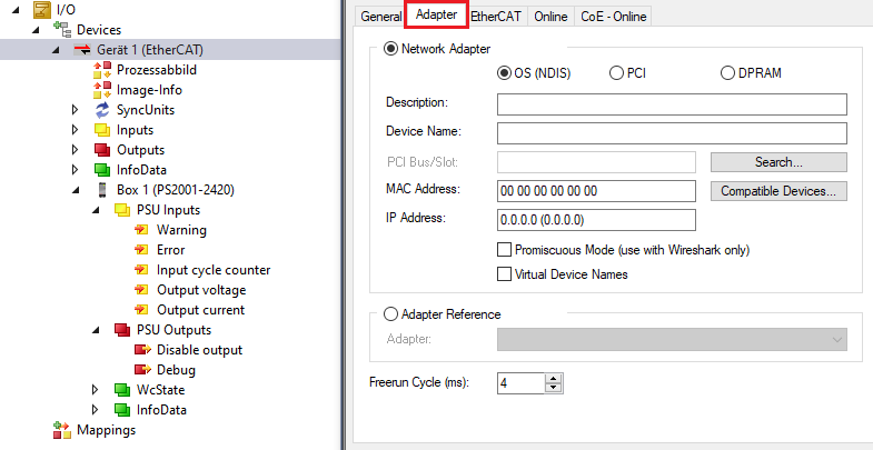

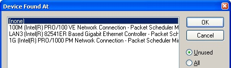

A real Ethernet port on the runtime system must then be assigned to this virtual device.
OFFLINE configuration creation 3:Fig.73: Selection Ethernet port
This query can appear automatically when the EtherCAT device is created, or the assignment can be set/changed later in the properties dialog; see Fig. "EtherCAT device properties (TwinCAT 3)".
OFFLINE configuration creation 4:Fig.74: EtherCAT device properties (TwinCAT 3)
TwinCAT 3: the properties of the EtherCAT device can be opened by double click on “Device .. (EtherCAT)” within the Solution Explorer under “I/O”:

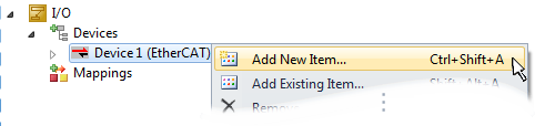

Further devices can be appended by right-clicking on a device in the configuration tree.
OFFLINE configuration creation 7:Fig.75: Appending EtherCAT devices (TwinCAT 3)

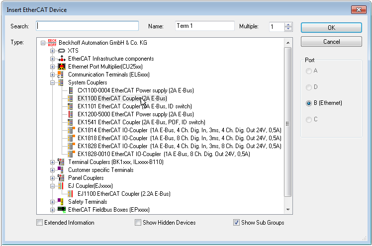

The dialog for selecting a new device opens. Only devices for which ESI files are available are displayed.
The selection also only offers devices that are to be added to the previously clicked device - the physical layer possible on this port is displayed (Fig. "New EtherCAT device selection dialog", A). It can be wired FastEthernet Ethernet physics with PHY transmission, in which case only wired devices can be selected, as shown in the "New EtherCAT device selection dialog". If the previous device has several free ports (e.g. EK1122 or EK1100), the desired port can be selected on the right-hand side (A).
Overview of physical layer

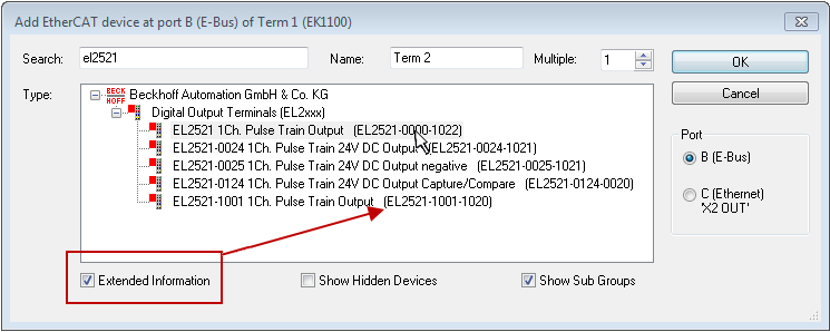

By default only the name/type of the device is used as selection criterion. For selecting a specific revision of the device the revision can be displayed as “Extended Information”.
OFFLINE configuration creation 9:Fig.77: Display of device revision

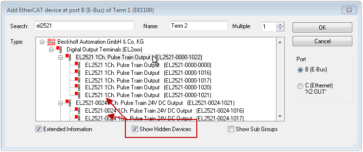

In many cases several device revisions were created for historic or functional reasons, e.g. through technological advancement. For a simplified display (see Fig. "New EtherCAT device selection dialog"), only the last (=highest) revision and thus the last production status is displayed in the selection dialog for Beckhoff devices. If all revisions of a device available in the system as ESI descriptions are to be displayed, the "Show Hidden Devices" checkbox must be selected, see Fig. "Display of previous revisions".
OFFLINE configuration creation 10:Fig.78: Display of previous revisions

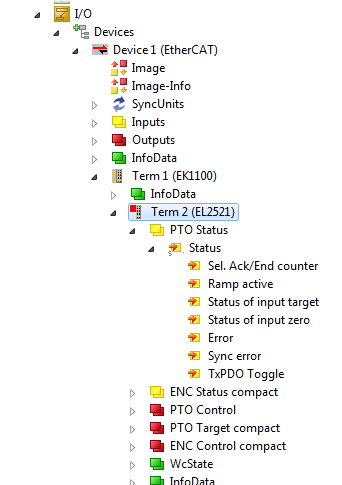

The device is then displayed with its process image in the configuration tree and can only be parameterized: Linking with the task, CoE/DC settings, PlugIn definition, StartUp settings, ...
OFFLINE configuration creation 13:Fig.80: EtherCAT Terminal in the TwinCAT tree (TwinCAT 3)
