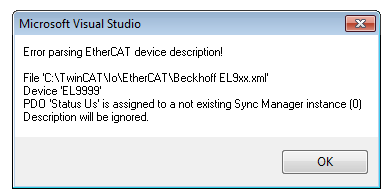

Faulty ESI file
If there is a faulty ESI file that cannot be read by the System Manager, the System Manager displays an information window.
Notes regarding ESI device description 3:Fig.66: Information window faulty ESI file (TwinCAT 3)
This can be caused by

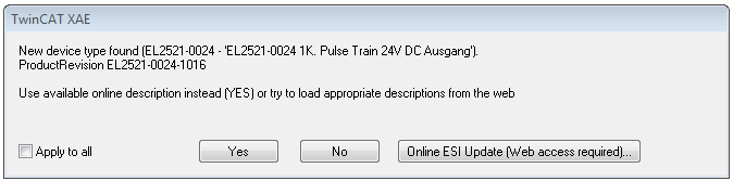

If the EtherCAT configuration is created online by scanning real existing devices (see chapter Online creation) and there is no ESI description available for a slave found (identified by name and revision), the System Manager asks whether it should use the description available in the device. The System Manager always requires this information in order to set the cyclical and acyclical communication with the slave correctly.
A window appears in TwinCAT 3 that also offers the web update:
Notes regarding ESI device description 4:Fig.67: OnlineDescription information window (TwinCAT 3)
If possible, the Yes is to be rejected and the required ESI is to be requested from the device vendor. After installation of the XML/XSD file the configuration process should be repeated.

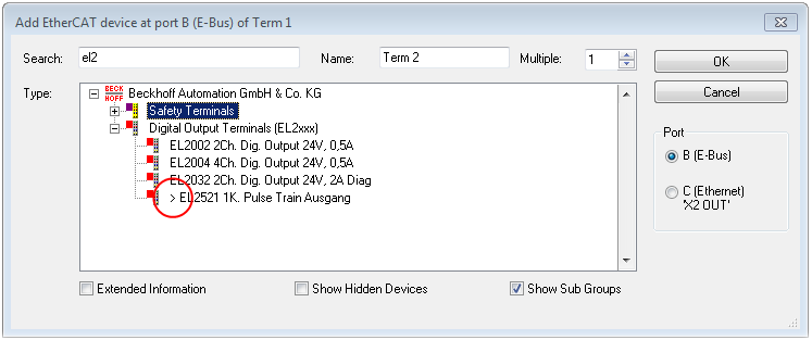

If a slave is then to be added manually to the configuration, slaves created "online" are identified by a preceding ">" symbol in the selection list (see figure Identification of an ESI recorded online using the EL2521 as an example).
Notes regarding ESI device description 6:Fig.69: Identification of an ESI recorded online using the EL2521 as an example
