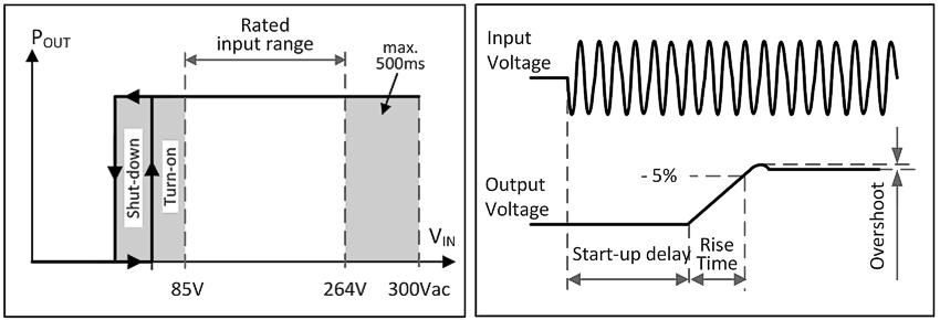

Voltage range 1 | Nom. | AC 120 - 240 V (-15% / +10%) | Suitable for TN, TT and IT networks |
AC input range | Min. | 85 - 264 Vac |
Min. | 264 - 300 Vac | For up to 500 ms max. | |

Turn-on voltage | Typ. | 82 Vac | Static, see Fig. Input voltage range; turn-on behavior definitions |
Shut-down voltage | Typ. | 72 Vac | Static, see Fig. Input voltage range; turn-on behavior definitions |

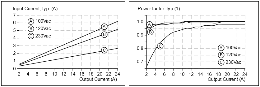

Input current | Typ. | 5.15 A | 4.26 A | 2.23 A | At 24 V, 20 A, see Fig. Input current vs. output current; power factor vs. output current |
Power factor*) | Typ. | 0.99 | 0.99 | 0.98 | At 24 V, 20 A, see Fig. Input current vs. output current; power factor vs. output current |

Inrush delay | Typ. | 600 ms | 550 ms | 500 ms | See Fig. Input voltage range; turn-on behavior definitions |
Rise time | Typ. | 110 ms | 110 ms | 110 ms | At 24 V, 20 A constant current load, 0 mF load capacitance, see Fig. Input voltage range; turn-on behavior definitions |
Typ. | 120 ms | 120 ms | 120 ms | at 24 V, 20 A constant current load, 20 mF load capacitance, see Fig. Input voltage range; turn-on behavior definitions | |
Turn-on overshoot | Max. | 200 mV | 200 mV | 200 mV | See Fig. Input voltage range; turn-on behavior definitions |

Fig.3: Input voltage range, Turn-on behavior definitions
Fig.4: Input current vs. output current; power factor vs. output current
