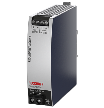

PS9401-2440-0000 – Redundancy Module
Redundancy and Buffer Modules 1:
The PS9401-2440-0000 is a redundancy module that can be used for the construction of 1+1 and N+1 redundancy systems.
It has two input channels, to which power supplies with output currents of up to 20 A can be connected, and one output that can carry nominal currents of up to 40 A.
The redundancy module uses MOSFET technology instead of diodes for decoupling the two input channels. This reduces the heat development and the voltage drop between input and output. Due to the low power loss, the device is very narrow and requires a width of just 36 mm on the DIN rail.
Large connection terminals enable secure and fast installation.
The redundancy module requires no additional auxiliary voltage.
Due to the international approvals package, the device is suitable for virtually every application.
Observe the connection instructions in the chapter "Parallel use for redundancy”
