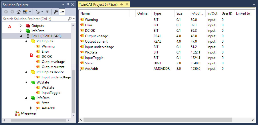

Process data 1:Fig.134: Default process data using the PS2001-2420-1001 as an example
The plain text display of the bit meanings of the status word is particularly helpful for commissioning, but also for linking with the PLC program.
By right-clicking on the status variable in the configuration tree (A), the structure can be opened for linking (B).
