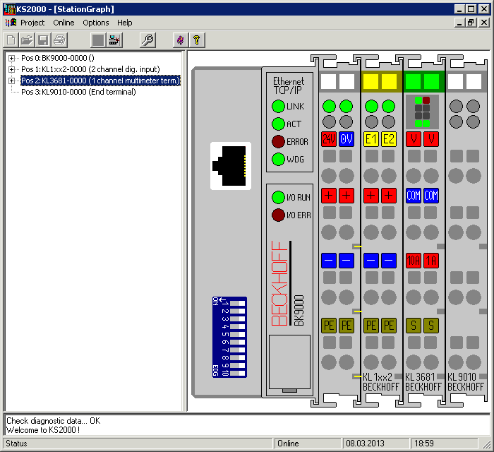

Connect the configuration interface of your Fieldbus Coupler with the serial interface of your PC via the configuration cable and start the KS2000 configuration software.
Click on the Login button. The configuration software will now load the information for the connected fieldbus station. In the example shown, this is
The left-hand KS2000 window displays the terminals of the fieldbus station in a tree structure.
The right-hand KS2000 window contains a graphic display of the fieldbus station terminals.
In the tree structure of the left-hand window, click on the plus-sign next to the terminal whose parameters you wish to change (item 2 in the example).
For the KL3404, the branches Register, Settings and ProcData are displayed:
