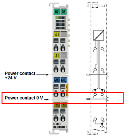

- PGND
- also called: GNDPC, 0 V, power contact 0 V, “-“ (opposite to this positive power contact: “+”).
- Version: PGND is a structural description of the "negative" power contact rail of the Bus Terminal system.
- Can be connected to the device electronics, for example for supplying power to the device or as a signal feedback (see chapter Ground reference: single-ended/differential typification). Refer to the respective device documentation.
- Example: PGND is not connected to the device electronics (the analog signal refers to a separate AGND):

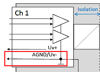

- AGND
- Also called: GNDint, GND, analog ground, GNDanalog.
- AGND electrically designates the device's analog reference ground.
- AGND can, for example, be internally connected to PGND or to a connection point so that it can be connected externally to a desired potential. Electrical restrictions according to the device documentation must be observed, e.g. common mode limits.
- AGND is usually a currentless reference potential. The action of interference on AGND must be avoided.
- Example: AGND is fed out on the device plug:
