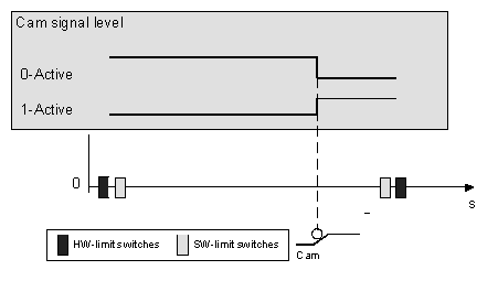

Cam switch signal level
The level when the cam switch is actuated can either be logical zero (0-active) or one (1-active). The level is set with the sequence parameter P-AXIS-00038 (cam_level).
0: 0-active
1: 1-active
Cam switch signal level 1:Fig.14: Cam signal level
