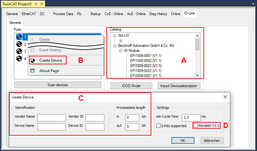

1. The IODD of the IO link device is already available:
Select the respective device from the “Catalog” field sorted by manufacturer (see following figure (A)).
2. No IODD is available:
Add the device can be manually via “Create Device”. These data are not saved in the “Catalog” field and must be manually entered for each port.
3. Right-click on the port to open the context menu (see the figure below (B)) and select “Create Device”.
4. In the “Create Device” dialog an IO-Link device with the basic communication parameters can be created. The mandatory fields here are: For Vendor ID, Device ID and process data length see the figure below (C). The values VendorID and DeviceID can be entered both in hexadecimal notation (input format: 0xnnnn) and as decimal numbers (nnnn).
The communication parameters to be entered can be found in the information provided by the device vendor.
5. If the IO-Link device version is 1.1, then the parameter server is activated by the selection of the check box “Revision V1.1” (see following figure (D)).
6. Activate the IO link configuration, so that changes become effective.
4. Manual insertion via Create Device 1:Fig.19: Manual creation of an IO-Link device via the "Create Device" dialog (C)
4. Manual insertion via Create Device 2:
