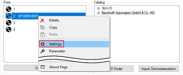

To find the basic settings of the devices for each port, proceed as follows.
- 1. right-click on the port to open the context menu and select “Settings”.
- A new tab “Portx:: Settings” opens where the settings described below can be made.
Fig.22: Context menu - Settings

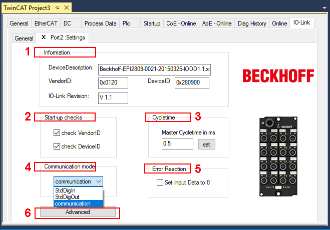

Fig.23: Settings of the IO-Link devices- 1. Information
This field is for information only; the IODD that was read in is displayed under Device Description. Furthermore, the VendorID, DeviceID and the IO-Link revision (V1.0 or V1.1) of the IO-Link devices are displayed. If the device is an IO-Link device V1.1, then the parameter server function is supported.
The following settings can be made in the settings for the IO-Link devices (see figure above):
- 2. Start-up checks
This parameter can be used to specify that the Vendor ID and Device ID should be checked when the IO-Link device starts up. - This avoids errors when exchanging IO-Link devices.
- 3. CycleTime
Specifies the cycle time for the IO-Link master - 4. Communication mode
Selection of the mode in which the IO-Link port is to be operated. - “Communication”: Default mode for IO-Link devices
- “StdDigIn / StdDigOut”: Mode for non-IO-Link devices, automatically selected if the port is configured as a digital input or output.
- 5. Error Reaction
If the “Set Input Data to 0” field is activated: - input data are set to 0 in case of error
- Status display: “Error”

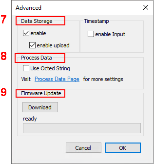

- 6. Button "Advanced"
