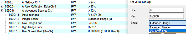

Notice
Invalid error limits following a change to the “Integer Scaler”
If the “Integer Scaler” parameter is changed, the error limits (“Range Error”) are not automatically updated. As a result, measured values may be incorrectly interpreted as invalid or valid after a change.
  • After each change to “Integer Scaler”, also set the parameter “Input Interface”.
  • Changing the “Input Interface” sets the correct error limits, taking into account the configured “Integer Scaler”.
  • If the “Input Interface” is already set correctly when you change the “Integer Scaler”, you must temporarily set the “Input Interface” to a different value and then reset it to the correct value.

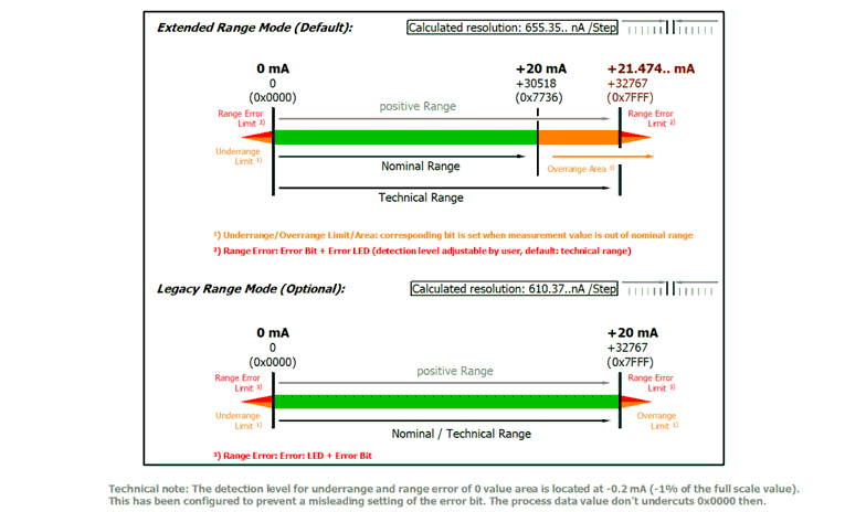

Setting:
Integer scaler (only when using PDO SINT16) 2:
Fig.27: Setting Index 0x80nD:12, Legacy Range, Extended Range
Depending on the interface, this then means SINT16 -> Real32 for the conversion in the controller (if the over/underrange PDO is set to the default setting):

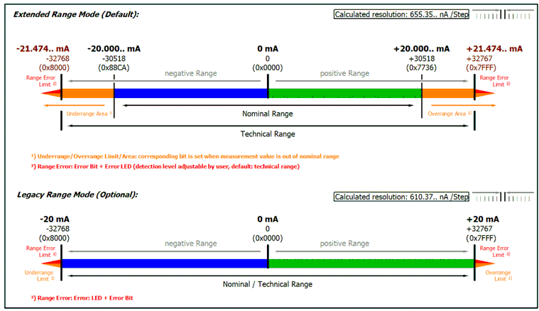

Measuring range ±20 mA (bipolar)
Integer scaler (only when using PDO SINT16) 3:
Measuring range 0…20 mA (current loop)
Integer scaler (only when using PDO SINT16) 4:

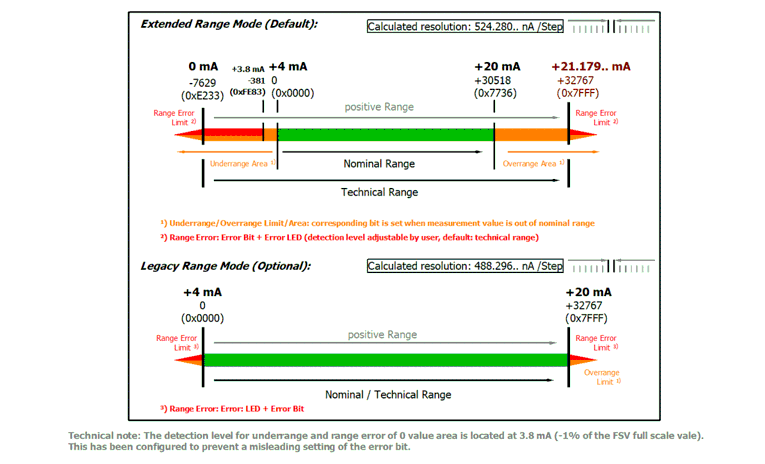

Measuring range 4…20 mA (current loop)

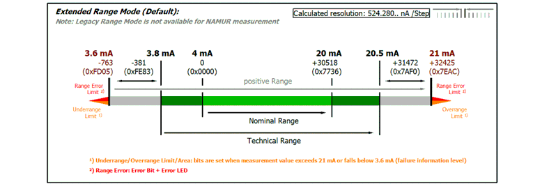

Measuring range 4…20 mA, NAMUR NE43 (current loop)
