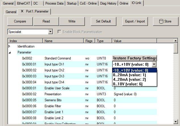

Selection of the analog signal type, index 0x3800:0n
In delivery state, all channels of the EPI31x4, ERI31x4 are set for analog voltage measurement (-10 V …+10 V).
NOTICE
Setting the correct signal type before connecting the sensors
Set the correct signal type before connecting the sensors!
This setting can be set individually for each channel in parameter 0x3800:0n (see the figure below). Changes become effective immediately after writing the parameter.
Selection of the analog signal type, index 0x3800:0n 1:
