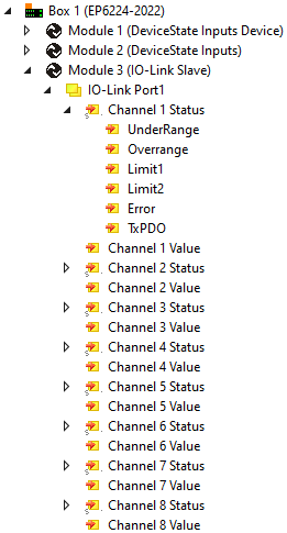

Process image
The status information of the first analog channel can be found under "Channel 1 Status".
You will find the measured value of the first analog channel under "Channel 1 Value" .
