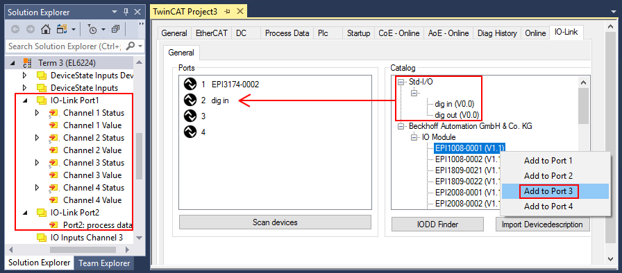

Configuration of the IO-Link ports as digital in- or output
IO-Link ports can also be configured as digital inputs or digital outputs. This allows digital sensors and actuators having no IO-Link functionality to be connected to IO-Link ports.
- 1. Expand the "Std-I/O" tree node in the "Catalog" field.
- The operating modes "dig in" and "dig out" appear.
- 2. Configure the desired port. There are two ways to do this:
- Drag-and-drop: pull "dig in" or "dig out" onto the port in the "Ports" field or
- Right-click on "dig in" or "dig out" and click on "Add to Port n“.
Example of port assignment on the IO link master EL6224
Port1: | Port2: | Port3: |
Process data of Port1 and Port2 are displayed in the Solution Explorer. | ||
