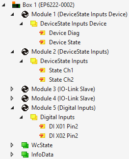

Process image EP6222-0002
Process image EP6222-0002 1:
Process image EP6222-0002 2: Module 1
Diagnostics.
See chapter Further error diagnosis.
Process image EP6222-0002 3: Module 2
Status variables of the IO-Link ports.
See chapter Status of the IO-Link ports.
Process image EP6222-0002 4: Module 3 1)
Process data of the IO-Link device at port X01
Process image EP6222-0002 5: Module 4 1)
Process data of the IO-Link device at port X02
Process image EP6222-0002 6: Module 5
Digital inputs.
1) The modules "Module 3" to "Module 4" only exist in the process data if the corresponding IO-Link ports have been configured.
