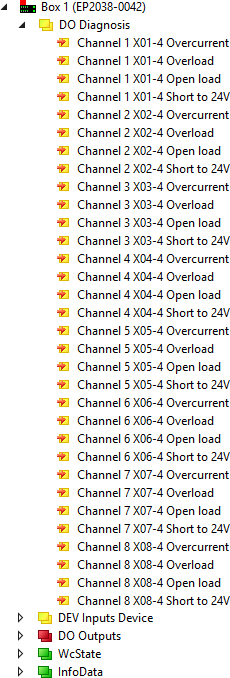

DO Diagnosis
Notice
Some diagnostic functions are disabled in the factory setting
The following errors are only reported if you enable them beforehand:
"Open load"
"Short to 24V"
At DO Diagnosis you will find the diagnostic bits of the digital outputs.
EP2038-0042 - Process image 1:
If you do not want to evaluate the diagnostic information, you can also remove this process data object from the process image. To do this, select the Predefined PDO Assignment "8DO" instead of "8DO full diagnosis".
