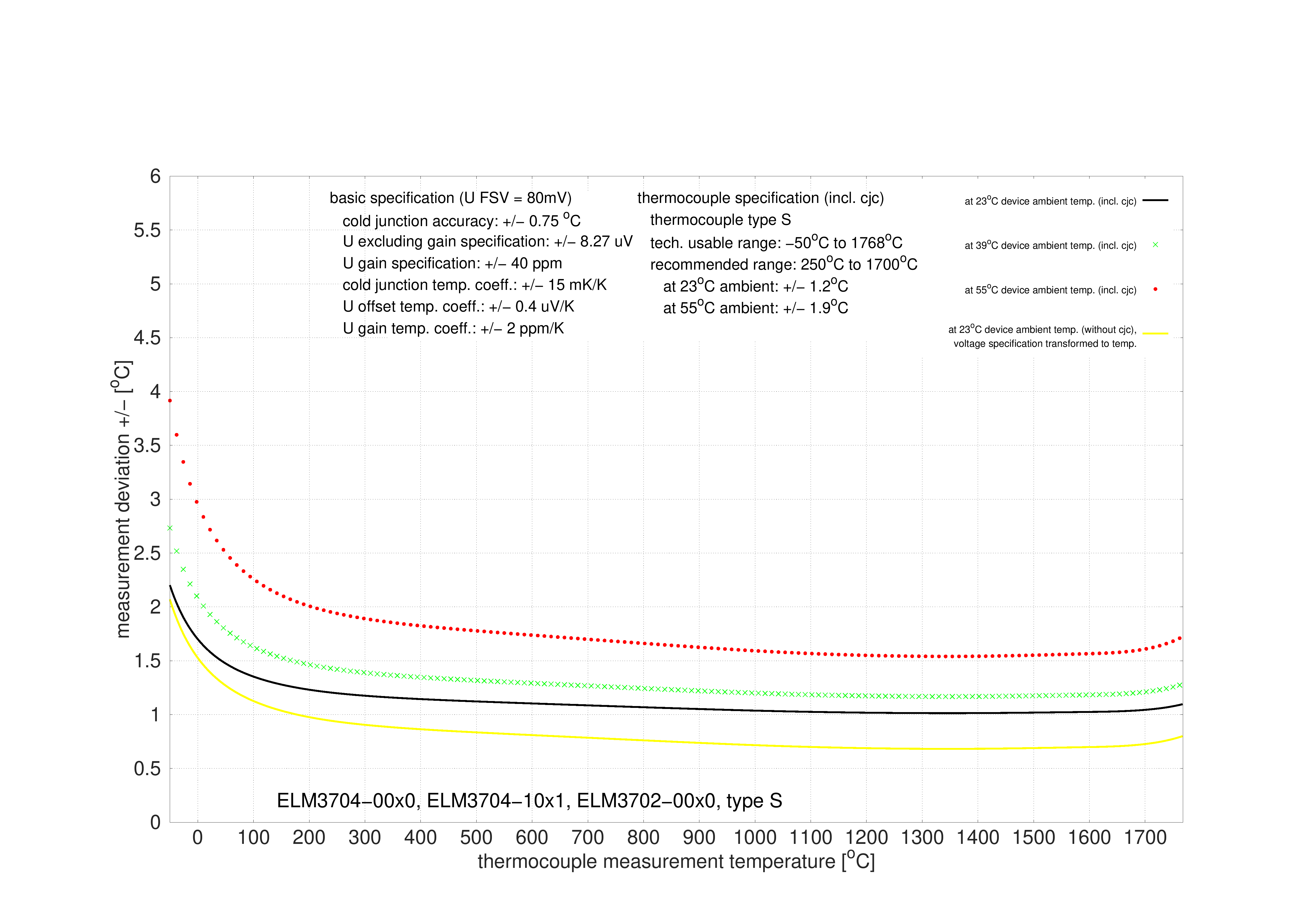

Uncertainty in the recommended measuring range, with averaging
@ 23 °C ambient temperature
±1.2 K ≈ ±0.07 %FSV
@ 55 °C ambient temperature
±1.9 K ≈ ±0.11 %FSV
Temperature coefficient
(Change of the measured value by changing of the terminal ambient temperature)
Because the value is strongly dependent by the sensor temperature as shown on the bottom given specification plot, it has to be basically derived by the specification plot. For a better approach the measurement uncertainty at Tambient=39°C as the middle between 23°C and 55°C is additionally informative represented in order to clarify the non-linear course.

Measurement uncertainty for TC type S:
Specification type S 1:
