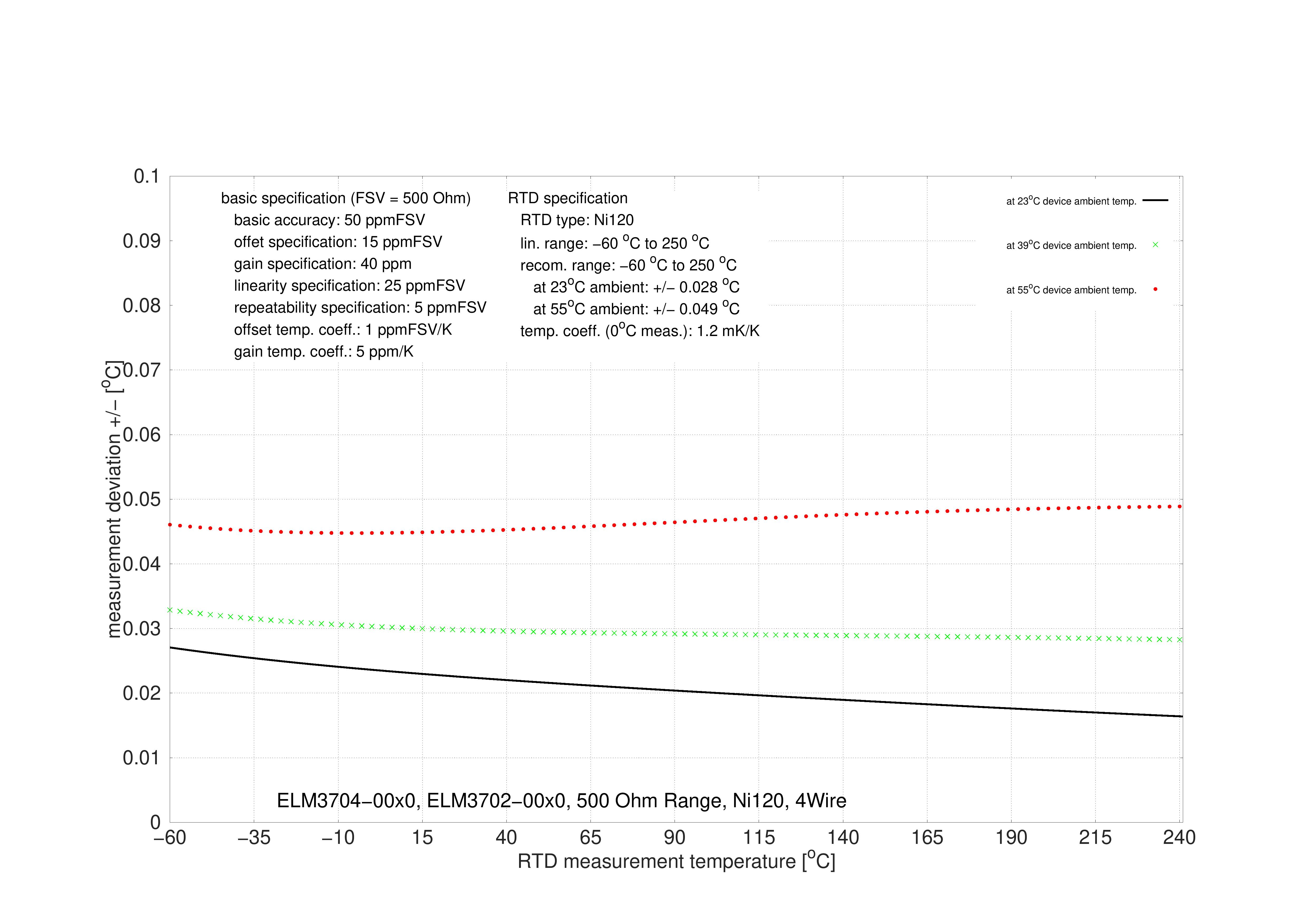

Measurement uncertainty for Ni120 in the electr. measuring range 500 Ω, 4-wire connection:
NI120 specification 1:

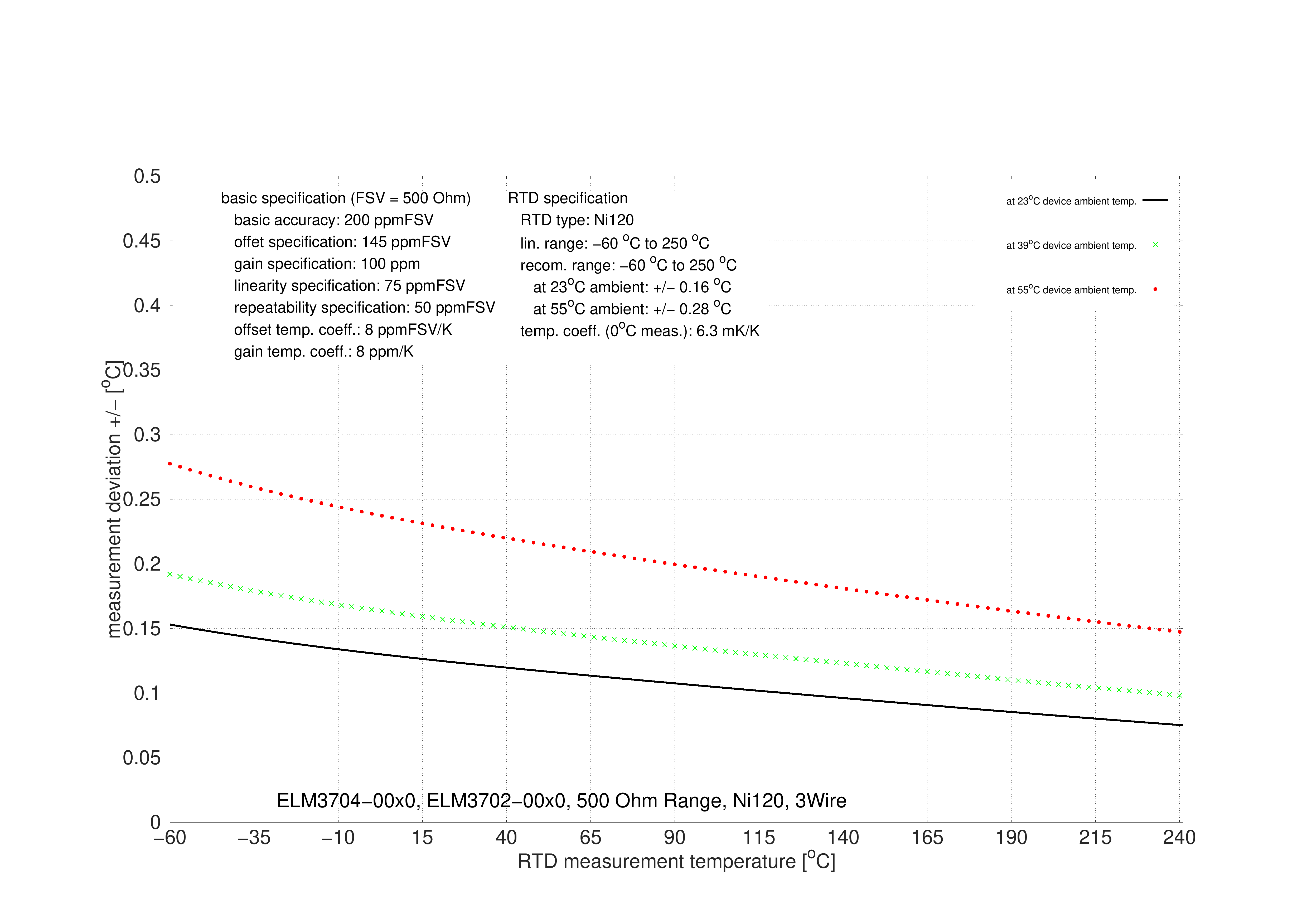

Measurement uncertainty for Ni120 in the electr. measuring range 500 Ω, 3-wire connection:
NI120 specification 2:

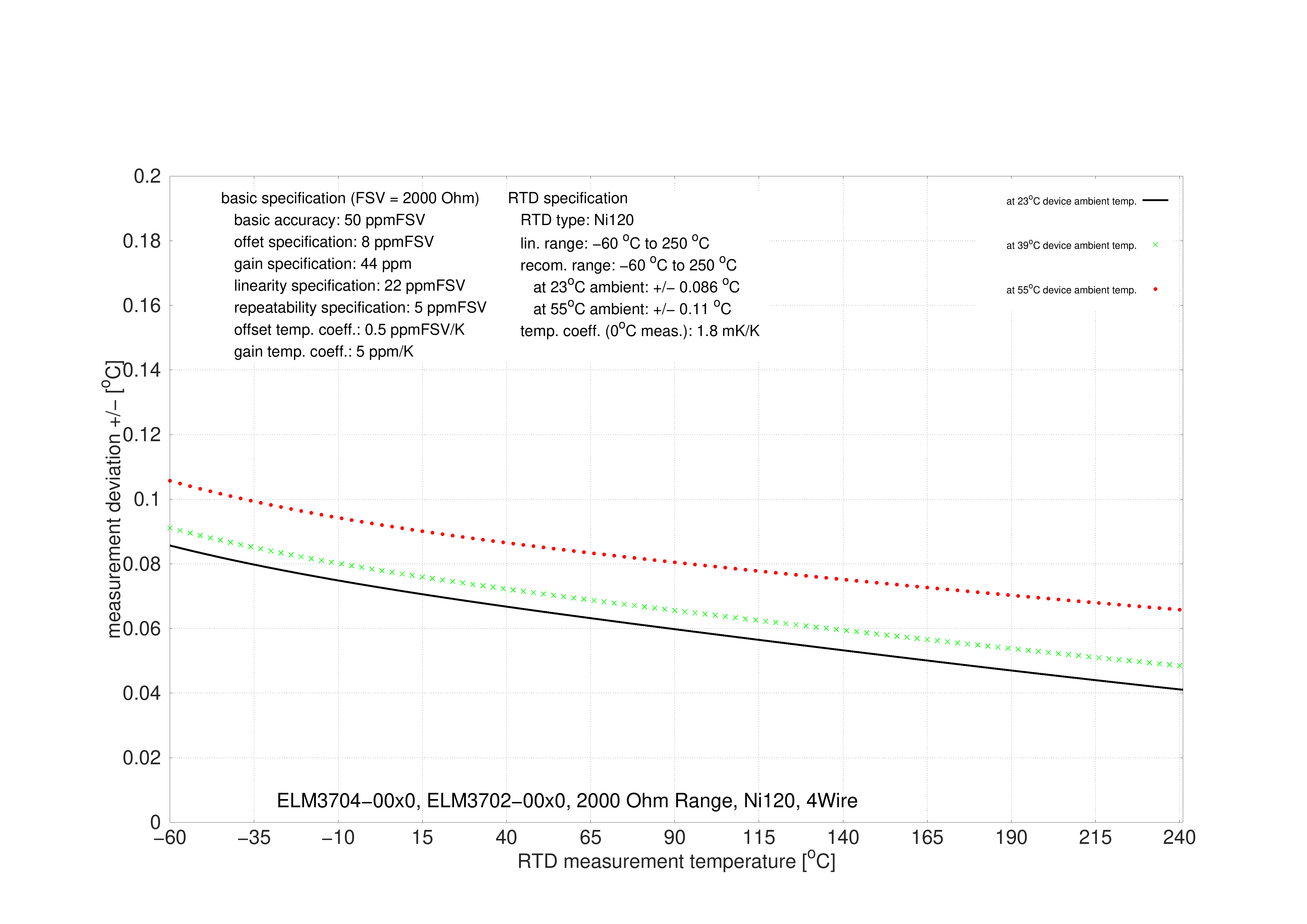

Measurement uncertainty for Ni120 in the electr. measuring range 2000 Ω, 4-wire connection:
NI120 specification 3:

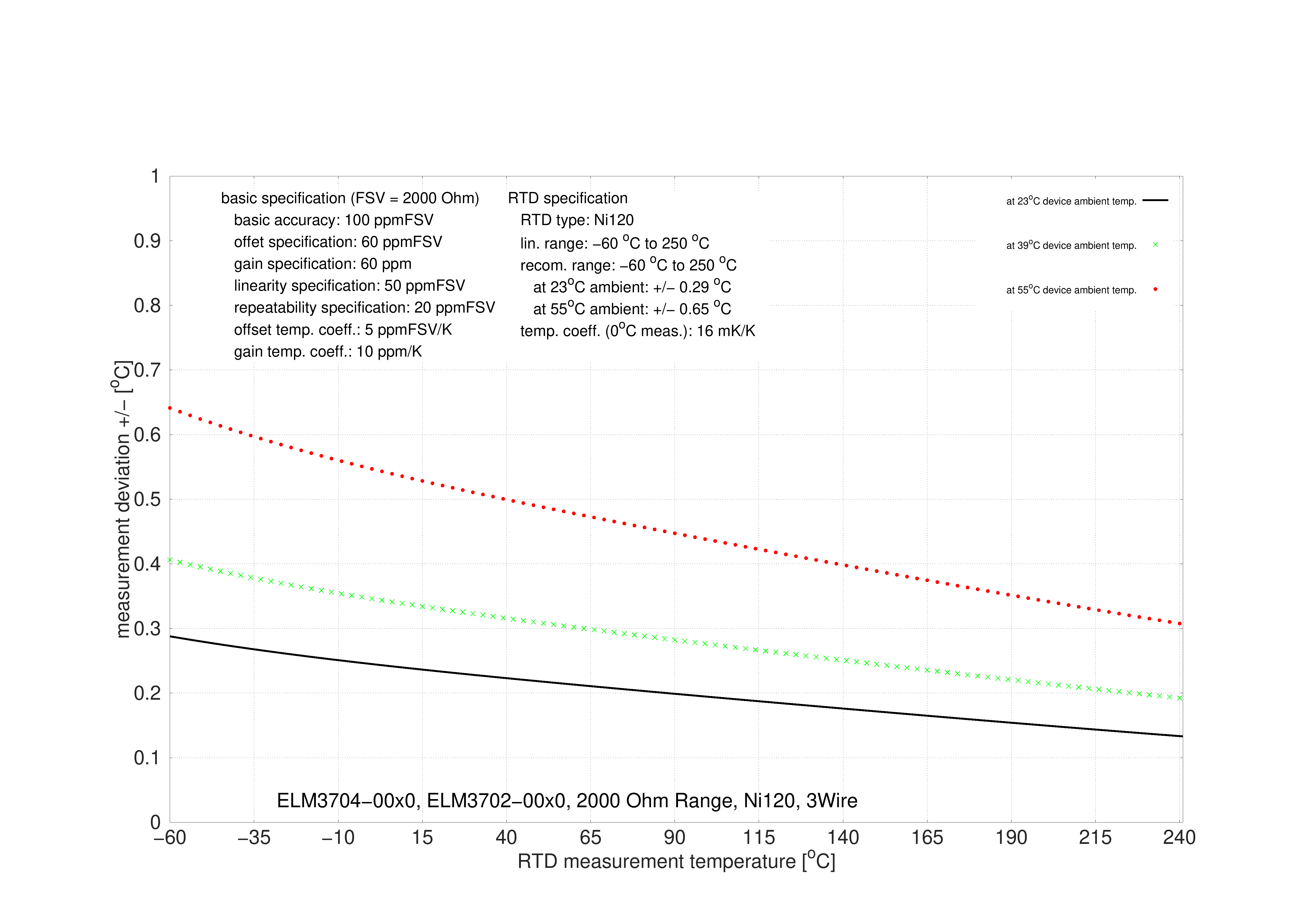

Measurement uncertainty for Ni120 in the electr. measuring range 2000 Ω, 3-wire connection:
NI120 specification 4:

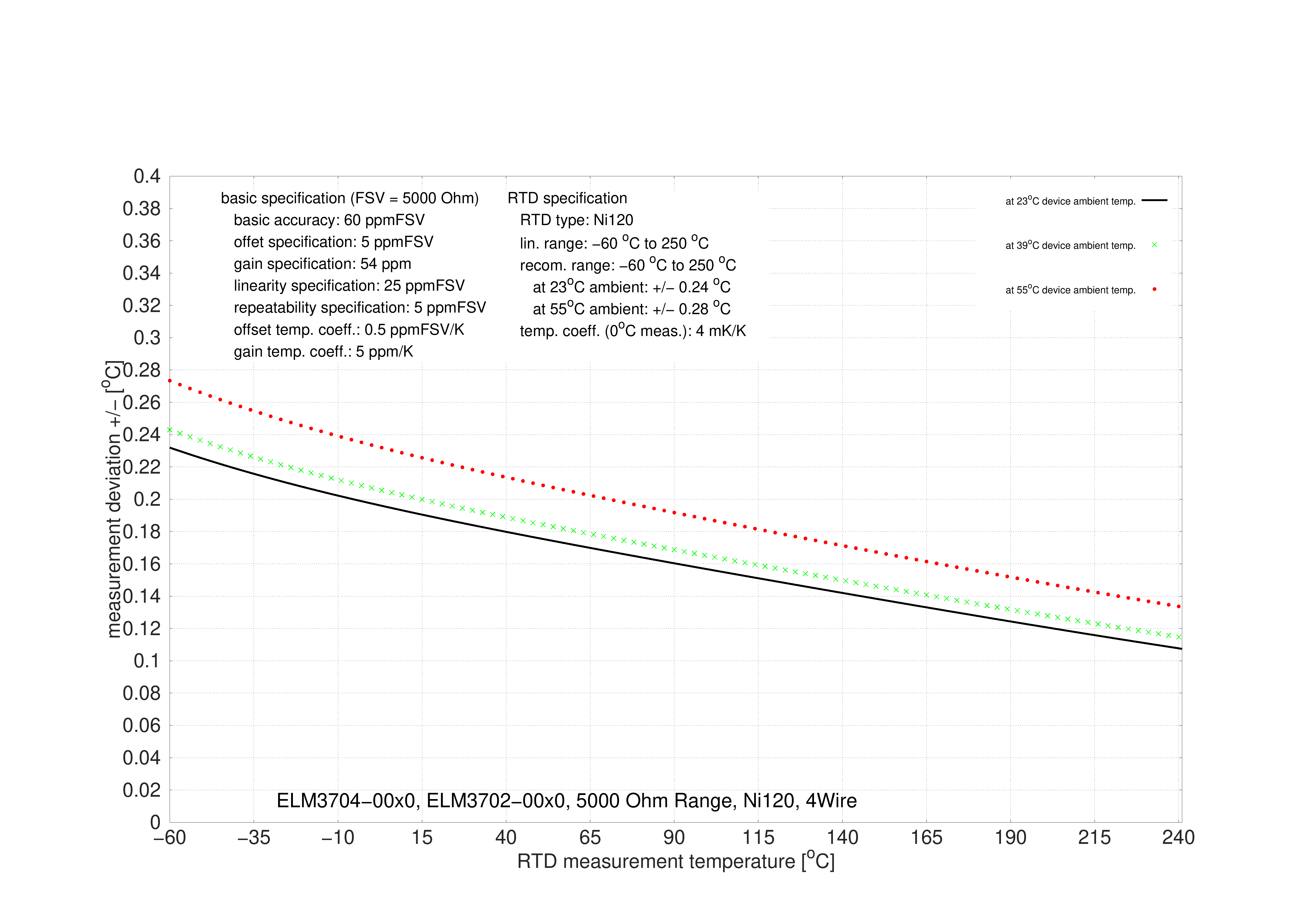

Measurement uncertainty for Ni120 in the electr. measuring range 5000 Ω, 4-wire connection:
NI120 specification 5:
