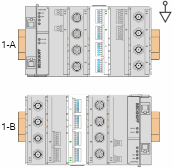

Fig.348: Mounting rail with terminal block mounted horizontally on a lateral surface- 1-A: Mounted laterally, from left to right
- 1-B: Mounted laterally, from right to left

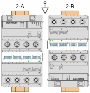

Fig.349: Support rail with terminal block mounted vertically on a lateral surface- 2-A: Mounted laterally, from top to bottom
- 2-B: Mounted laterally, from bottom to top

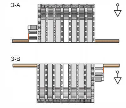

Fig.350: Mounting rail with terminal block mounted on a surface facing upwards or downwards- 3-A: Mounting rail underneath, connection side faces upwards
- 3-B: Mounting rail at top, connection side faces downwards
