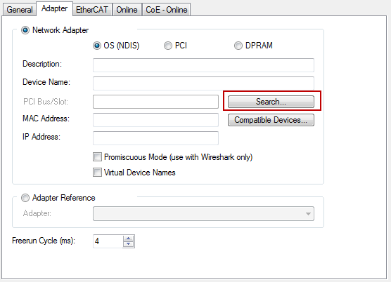

- The EtherCAT device of the example should usually be declared your present system. After selection of the EtherCAT device in the “Solutionexplorer” select the “Adapter” tab and click on “Search...”:
- Checking NetId: the “EtherCAT” tab of the EtherCAT device shows the configured NetId:
The first four numbers must be identical with the project NetId of the target system. The project NetId can be viewed within the TwinCAT environment above, where a pull down menu can be opened to choose a target system (by clicking right in the text field). The number blocks are placed in brackets there next to each computer name of a target system. - Modify the NetId: By right clicking on “EtherCAT device” within the solution explorer a context menu opens where “Change NetId...” have to be selected. The first four numbers of the NetId of the target computer must be entered; both last values are 4.1 usually.
Example: - NetId of project: myComputer (123.45.67.89.1.1)
- Entry via „Change NetId...“: 123.45.67.89.4.1

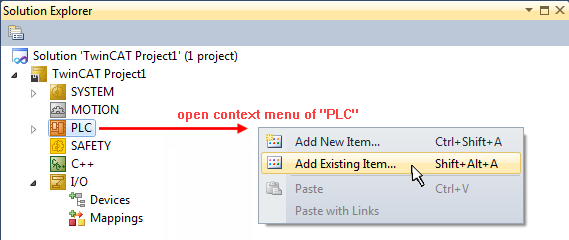

- After clicking the Download button, save the zip file locally on your hard disk, and unzip the *.tpzip -archive file into a temporary working folder.
- Create a new TwinCAT project as described in section:
TwinCAT Quickstart, TwinCAT 3, Startup - Open the context menu of "PLC" within the "Solutionexplorer" and select "Add Existing Item..."
- Select the beforehand unpacked .tpzip file (sample program).
