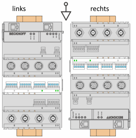

Vertical installation
In the vertical installation position, the mounting rail is mounted vertically on a vertical mounting plate; the connection points for the terminals face forwards. The underside of the device (in relation to the standard installation position) sometimes faces
Reference direction is downwards (see arrow): this shows the direction of the earth's gravitational force

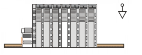

Flat installation
In the flat installation position, the mounting rail is laid on a horizontal mounting plate; the connection points for the terminals face upwards.

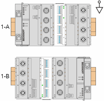

Installation position names
Installation positions 4:Fig.133: Mounting rail with terminal block mounted horizontally on a lateral surface
  • 1-A: Mounted laterally, from left to right
  • 1-B: Mounted laterally, from right to left

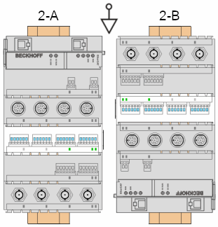

Other installation positions
All of the other installation positions (2-A, 2-B, and 3-A, 3-B) are characterized by different positions of the mounting rail which deviate from the optimal position.
The minimum distances to the environment as specified above also apply for these installation positions.
Installation positions 5:Fig.134: Support rail with terminal block mounted vertically on a lateral surface
  • 2-A: Mounted laterally, from top to bottom
  • 2-B: Mounted laterally, from bottom to top

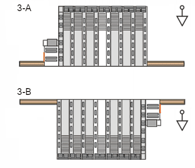

Installation positions 6:Fig.135: Mounting rail with terminal block mounted on a surface facing upwards or downwards
  • 3-A: Mounting rail underneath, connection side faces upwards
  • 3-B: Mounting rail at top, connection side faces downwards
