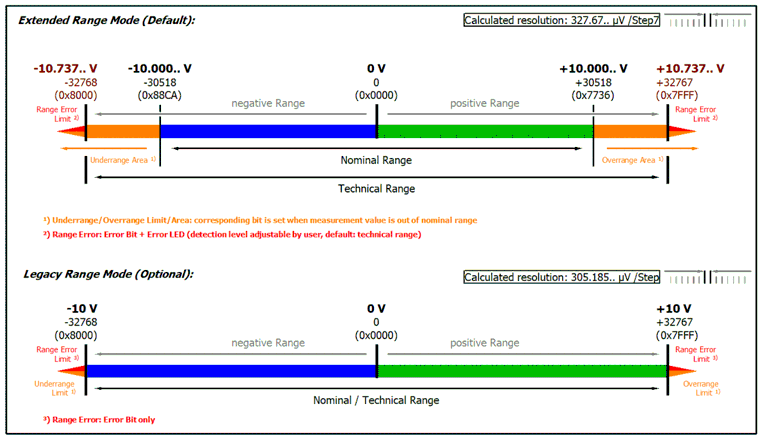

Measuring range ±10 V (bipolar)
Integer scaler (only when using PDO SINT16) 3:
Fig.84: Measuring range ±10 V

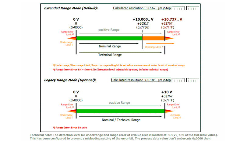

Measuring range 0…10 V (unipolar)
Integer scaler (only when using PDO SINT16) 4:
Fig.85: Measuring range 0…10 V (unipolar)

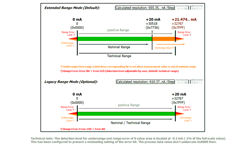

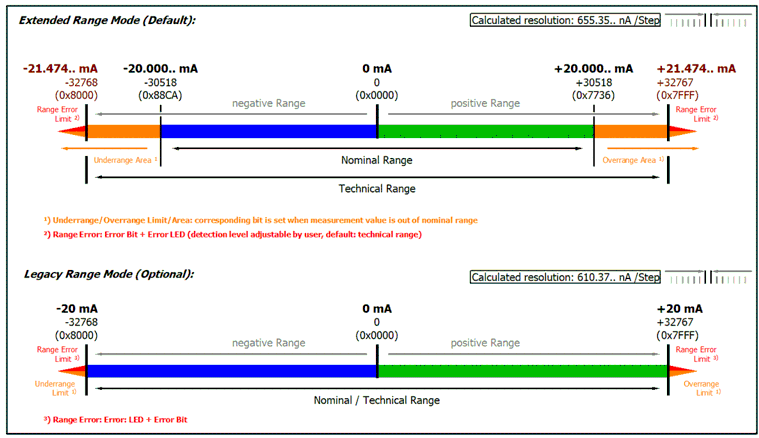

Measuring range ±20 mA (bipolar)
Integer scaler (only when using PDO SINT16) 5:
Fig.86: Measuring range ±20 mA (bipolar)

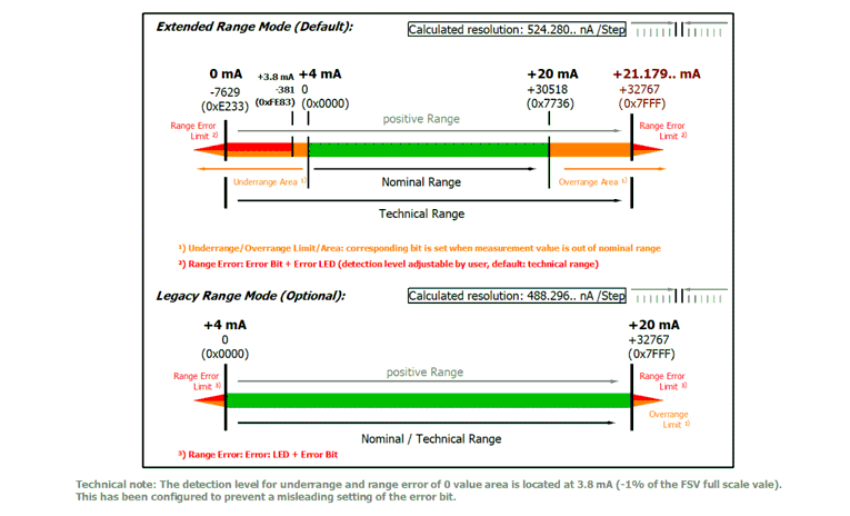

Measuring range 0…20 mA (current loop)
Integer scaler (only when using PDO SINT16) 6:
Fig.87: Measuring range 0…20 mA (current loop)
Measuring range 4…20 mA (current loop)
Integer scaler (only when using PDO SINT16) 7:
Fig.88: Measuring range 4…20 mA (current loop)

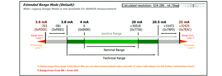

Measuring range 4…20 mA, NAMUR NE43 (current loop)
Integer scaler (only when using PDO SINT16) 8:
Fig.89: Measuring range 4…20 mA, NAMUR NE43 (current loop)
