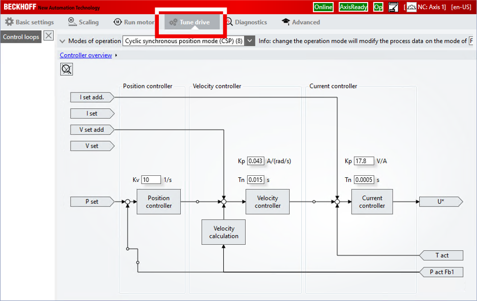

You can display the controller structure in Drive Manager 2 by selecting the "Tune Drive" menu. Click on individual elements in the controller structure to display their internal structure.
The CSP operation mode is set in the factory settings. Three controllers are active in this operation mode:
- Current controller
- Velocity controller
- Position controller
