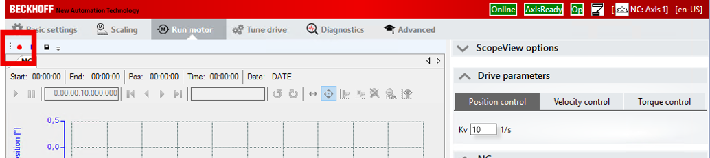

Preparation
1. Open the "Run motor" menu
2. Temporarily disable the position controller by setting the value Kv of the position controller to 0.
Optimization of the velocity controller 1:
3. Click the "Start record" button.
Optimization of the velocity controller 2:

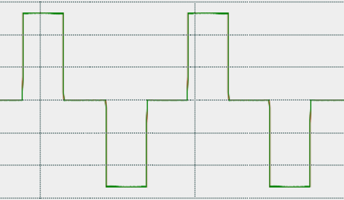

Example without oscillation:
Optimization of the velocity controller 3:

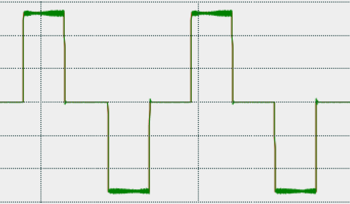

Example with oscillation:
Optimization of the velocity controller 4:
From here on, do not reduce the Tn value any further.
2. Increase Tn again until the motor no longer oscillates
3. Increase Tn a bit more, depending on the application
The integral component Tn is optimized.
