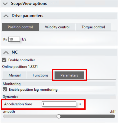

The acceleration time is set quite high in the factory setting. The motor accelerates only slowly.
You can set the acceleration time at "Parameters":
Dynamics 1:
Lower acceleration time increases the probability that a following error will occur. If necessary, increase the permissible following error. See chapter Following error monitor.
