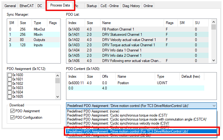

- 1. Set the operation mode "Drive Motion Control (DMC)" in CoE parameter 0x7010:03 "Modes of operation".
 - 2. Activate the Predefined PDO Assignment "Drive motion control (For TC3 DriveMotionControl Lib)".
 - The process data for using Drive Motion Control is activated.

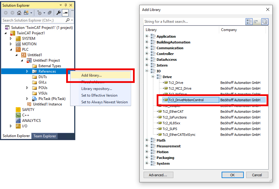

 - 4. Add the "Tc3_DriveMotionControl" library to the PLC project.
(If you want to use Drive Motion Control without the "Tc3_DriveMotionControl" library, see chapter State machine.)

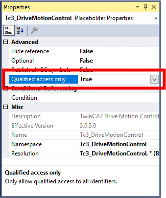

 - 5. If the “Tc3_DriveMotionControl” and “Tc2_Mc2” libraries are used simultaneously in the current project:
In the “Properties” window, set the “Qualified access only” property of one of the two libraries to “True”.
 - The library with “Qualified access only” can only be addressed in the PLC code via the corresponding namespace, e.g:
Tc3_DriveMotionControl.MC_Stop()
This avoids name conflicts, e.g. when calling the function blockMC_Stop, which has the same name in both libraries. - 6. Declare a variable of type “AXIS_REF” in the PLC. Sample:

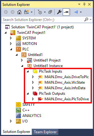

 - 8. In the Solution Explorer link the PLC variables with the process data of EL7062.
