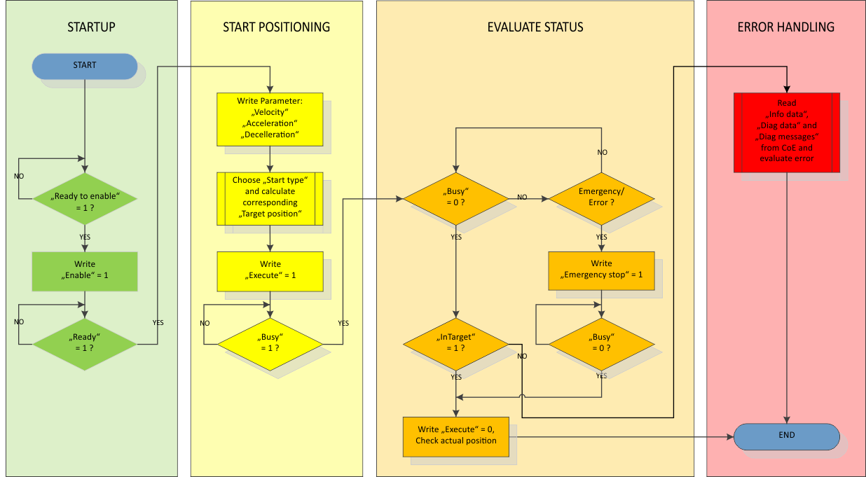

State machine
It is also possible to start travel commands without the function blocks of the library "Tc3_DriveMotionControl". This is based on the following state machine:

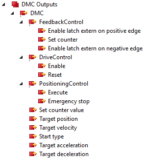

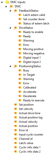

The variables for control and evaluation are located in the process data objects "DMC Inputs" and "DMC Outputs":
