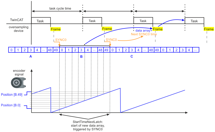

The temporal relationship is shown in the following example.
Example: Two EL5031-0011 Terminals with the same oversampling factor (n = 50)
The EtherCAT master, e.g. Beckhoff TwinCAT, configures both EL5031-0011 terminals such that their SYNC0 pulses occur at the same time.
Assumption: the EtherCAT bus cycle time TSYNC0 = 2 ms. This means that SYNC0 is triggered every 2 ms in all EL5031-0011.
- Both terminals work with a matching oversampling factor (e.g. n = 50),
 - the SYNC0 pulse occurs at the same time in both EL5031-0011,
The sampling time here is therefore TSYNC0 / 50 = 40 μs. - The SYNC0 signal in the terminal fills the internal buffer with 50 position values.
 - SYNC0 runs synchronously with the cycle time and triggers the provision of the filled buffer as process data. At the same time, the "StartTimeNextLatch" is retrieved from the local distributed clocks.
 - The data array is compiled together with the SYNC0 time (Next SYNC0 time).
 - The next EtherCAT cycle fetches this data.
Fig.137: EL5031-0011 – Temporal relationship between SYNC0 signal and SyncManager interrupt![]()  | Maximum sampling frequency, minimum cycle time Minimum sampling time (TSYNC0  / n), maximum sampling frequency (FSYNC0 * n) Minimum cycle time (TSYNC0)  |
