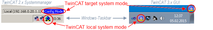

The TwinCAT 2 icon (
) or TwinCAT 3 icon (
) within the Windows-Taskbar always shows the TwinCAT mode of the local IPC. Compared to that, the System Manager window of TwinCAT 2 or the user interface of TwinCAT 3 indicates the state of the target system.

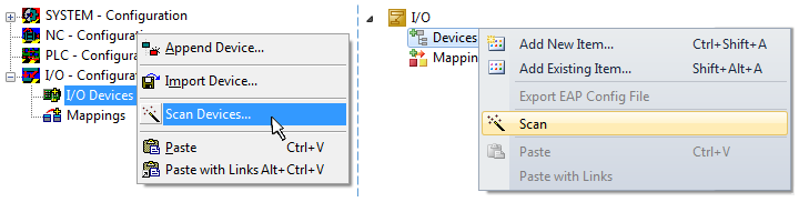

Fig.140: Differentiation local/target system (left: TwinCAT 2; right: TwinCAT 3)Right-clicking on “I/O Devices” in the configuration tree opens the search dialog.

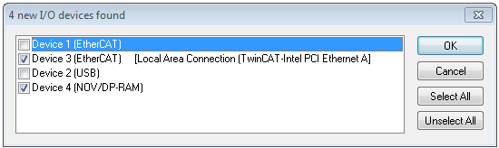

Fig.142: Note for automatic device scan (left: TwinCAT 2; right: TwinCAT 3)Ethernet ports with installed TwinCAT real-time driver are shown as “RT Ethernet” devices. An EtherCAT frame is sent to these ports for testing purposes. If the scan agent detects from the response that an EtherCAT slave is connected, the port is immediately shown as an “EtherCAT Device” .
Fig.143: Detected Ethernet devices Via respective checkboxes devices can be selected (as illustrated in Fig. “Detected Ethernet devices” e.g. Device 3 and Device 4 were chosen). After confirmation with “OK” a device scan is suggested for all selected devices, see Fig.: “Scan query after automatic creation of an EtherCAT device”.

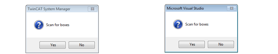

If an EtherCAT device was created in the configuration (manually or through a scan), the I/O field can be scanned for devices/slaves.
Fig.147: Scan query after automatic creation of an EtherCAT device (left: TwinCAT 2; right: TwinCAT 3)

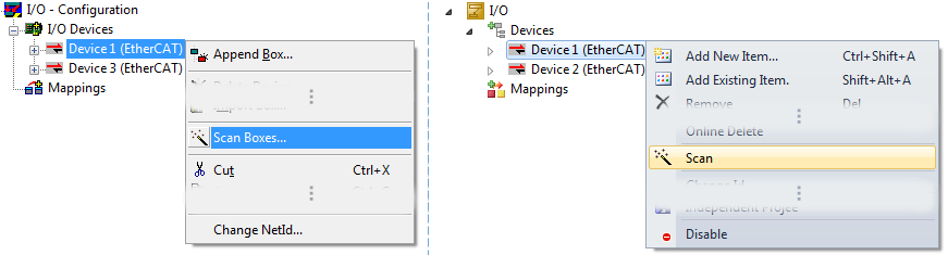

Fig.148: Manual scanning for devices on a specified EtherCAT device (left: TwinCAT 2; right: TwinCAT 3)In the System Manager (TwinCAT 2) or the User Interface (TwinCAT 3) the scan process can be monitored via the progress bar at the bottom in the status bar.

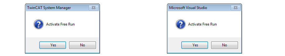

Fig.150: Config/FreeRun query (left: TwinCAT 2; right: TwinCAT 3)In Config/FreeRun mode the System Manager display alternates between blue and red, and the EtherCAT device continues to operate with the idling cycle time of 4 ms (default setting), even without active task (NC, PLC).
Fig.151: Displaying of “Free Run” and “Config Mode” toggling right below in the status bar

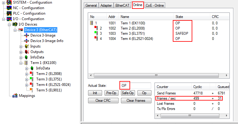

Fig.152: TwinCAT can also be switched to this state by using a button (left: TwinCAT 2; right: TwinCAT 3)The EtherCAT system should then be in a functional cyclic state, as shown in Fig. Online display example.
Fig.153: Online display example Please note:
- all slaves should be in OP state
- the EtherCAT master should be in “Actual State” OP
- “frames/sec” should match the cycle time taking into account the sent number of frames
- no excessive “LostFrames” or CRC errors should occur

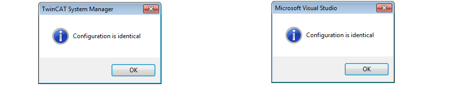

Change of the configuration after comparison With this scan (TwinCAT 2.11 or 3.1) only the device properties vendor (manufacturer), device name and revision are compared at present! A “ChangeTo” or “Copy” should only be carried out with care, taking into consideration the Beckhoff IO compatibility rule (see above). The device configuration is then replaced by the revision found; this can affect the supported process data and functions. |

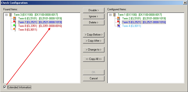

If a scan is initiated for an existing configuration, the actual I/O environment may match the configuration exactly or it may differ. This enables the configuration to be compared.

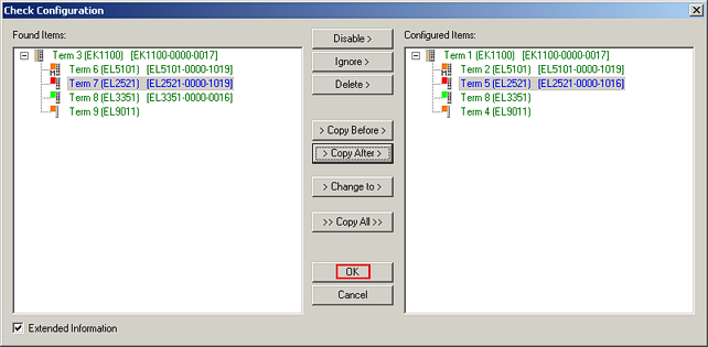

Fig.155: Identical configuration (left: TwinCAT 2; right: TwinCAT 3)If differences are detected, they are shown in the correction dialog, so that the user can modify the configuration as required.
Fig.156: Correction dialog It is advisable to tick the “Extended Information” check box to reveal differences in the revision.
Color | Explanation |
green | This EtherCAT slave matches the entry on the other side. Both type and revision match. |
blue | This EtherCAT slave is present on the other side, but in a different revision. This other revision can have other default values for the process data as well as other/additional functions. If the found revision is lower than the configured revision, it is likely that the slave cannot be used. The found device may not support all functions that the master expects based on the higher revision number. |
light blue | This EtherCAT slave is ignored (“Ignore” button) |

Fig.158: Correction dialog with modifications Once all modifications have been saved or accepted, click “OK” to transfer them to the real *.tsm configuration.

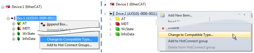

Change to Compatible Type
TwinCAT offers a function Change to Compatible Type… for the exchange of a device whilst retaining the links in the task.
Fig.159: Dialog “Change to Compatible Type…” (left: TwinCAT 2; right: TwinCAT 3)The following elements in the ESI of an EtherCAT device are compared by TwinCAT and assumed to be the same in order to decide whether a device is indicated as "compatible":

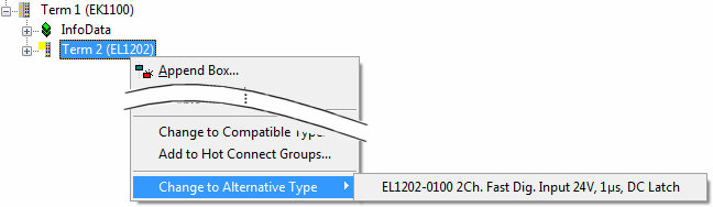

Change to Alternative Type
The TwinCAT System Manager offers a function for the exchange of a device: Change to Alternative Type
Fig.160: TwinCAT 2 Dialog Change to Alternative TypeIf called, the System Manager searches in the procured device ESI (in this example: EL1202-0000) for details of compatible devices contained there. The configuration is changed and the ESI-EEPROM is overwritten at the same time – therefore this process is possible only in the online state (ConfigMode).
