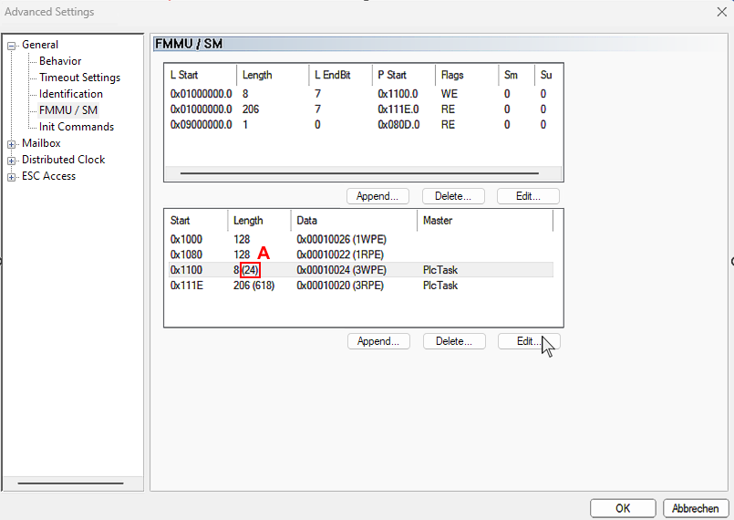

Using the EL3443 as a DPM current measurement terminal, shifting the start address Sync Manager
When using the terminal as a DPM current measurement terminal by activating the "DPM Data IN" PDO (0x1602), the start address of the last active Sync Manager must be shifted so that the object can be stored in the memory of the EtherCAT Slave Controller (ESC). Otherwise, the terminal will refuse to switch from the "PreOP" status to the "SafeOP" status.
First, the PDO Configuration must be selected by selecting the desired objects under the "Process Data" tab. If the object 0x1602 has been selected, the Sync Manager is adjusted under the "EtherCAT" tab. To do this, the corresponding screen (FMMU / SM) must be called up in the Advanced Settings.
Fig.162: Shifting start address Sync Manager, tab "Advanced Settings", value "A": Length of the third SMNow select the line of the third SYNC Manager and press the "Edit" button. In the following window, the start address is displayed in decimal form in the "Start Address" field ("B").

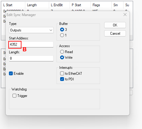

Fig.163: Decimal value of the start address of the third SMThe sum of the values "A" and "B" replaces the original start value of the last SYNC Manager, which is entered in the "Start Address" ("D") field by selecting the line and pressing the "Edit" button; in the example, this would be the value "4376dec"

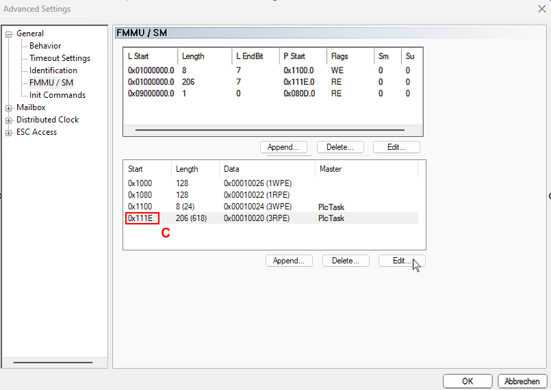

Fig.164: Replace the original start address "C" of the last SM

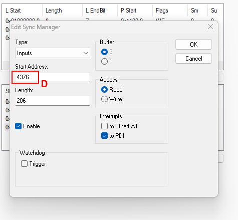

Fig.165: Enter the start address "D" of the last SM, sum of the values "A" and "B"Confirmation of variable output values 1 - 4
