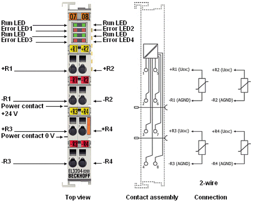

Fig.12: EL3204-0200 pin assignment
EL3204-0200 – pin assignment
Terminal point
No.
Comment
+R1
1
Input +R1, current-carrying
-R1
2
Input -R1, current-carrying
+R3
3
Input +R3, current-carrying
-R3
4
Input -R3, current-carrying
+R2
5
Input +R2, current-carrying
-R2
6
Input -R2, current-carrying
+R4
7
Input +R4, current-carrying
-R4
8
Input -R4, current-carrying

EL3204-0200 – LEDs
LED
Color
Meaning
RUN
green
This LED indicates the terminal's operating state:
off
State of the EtherCAT State Machine: INIT = initialization of the terminal or BOOTSTRAP = function for terminal firmware updates
flashing
State of the EtherCAT State Machine: PREOP = function for mailbox communication and different default settings set
single flash
State of the EtherCAT State Machine: SAFEOP = verification of the Sync Manager channels and the distributed clocks.
Outputs remain in safe state
on
State of the EtherCAT State Machine: OP = normal operating state; mailbox and process data communication is possible
ERROR1 - 4
red
Short circuit or wire break. The resistance value is in the invalid range of the characteristic curve.
