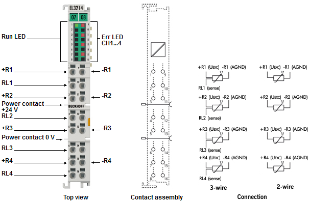

Fig.18: EL3214 pin assignment
EL3214 – pin assignment
Terminal point
No.
Comment
+R1
1
Input +R1, current-carrying
RL1
2
Input RL1, de-energized sense line
+R2
3
Input +R2, current-carrying
RL2
4
Input RL2, de-energized sense line
+R3
5
Input +R3, current-carrying
RL3
6
Input RL3, de-energized sense line
+R4
7
Input +R4, current-carrying
RL4
8
Input RL4, de-energized sense line
-R1
9
Input -R1, current-carrying
n. c.
10
not used
-R2
11
Input -R2, current-carrying
n. c.
12
not used
-R3
13
Input -R3, current-carrying
n. c.
14
not used
-R4
15
Input -R4, current-carrying
n. c.
16
not used

Pin assignment, display and diagnosis 2:
Connection of analog RTD signal lines
To ensure that the analog signals can be measured with as little interference as possible, also observe the notes in the chapter "Connection of analog RTD signal lines".
EL3214 – LEDs
LED
Color
Meaning
RUN
green
This LED indicates the terminal's operating state:
off
State of the EtherCAT State Machine: INIT = initialization of the terminal or BOOTSTRAP = function for terminal firmware updates
flashing
State of the EtherCAT State Machine: PREOP = function for mailbox communication and different default settings set
single flash
State of the EtherCAT State Machine: SAFEOP = verification of the Sync Manager channels and the distributed clocks.
Outputs remain in safe state
on
State of the EtherCAT State Machine: OP = normal operating state; mailbox and process data communication is possible
ERROR1 - 4
red
Short circuit or wire break. The resistance value is in the invalid range of the characteristic curve.
