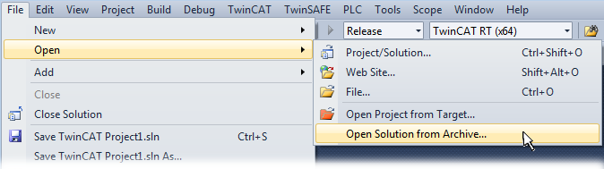

  • Click on the download button to save the Zip archive locally on your hard disk, then unzip the *.tnzip archive file in a temporary folder.
  • Example program 3: Access to TEDS with EL1262-0050 and EL2262 1:Fig.220: Opening the *. tnzip archive
  • Select the .tnzip file (sample program).
  • A further selection window opens. Select the destination directory for storing the project.

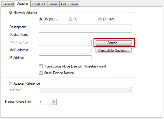

  • The EtherCAT device of the example should usually be declared your present system. After selection of the EtherCAT device in the “Solutionexplorer” select the “Adapter” tab and click on “Search...”:
  • Example program 3: Access to TEDS with EL1262-0050 and EL2262 2:Fig.221: Search of the existing HW configuration for the EtherCAT configuration of the example

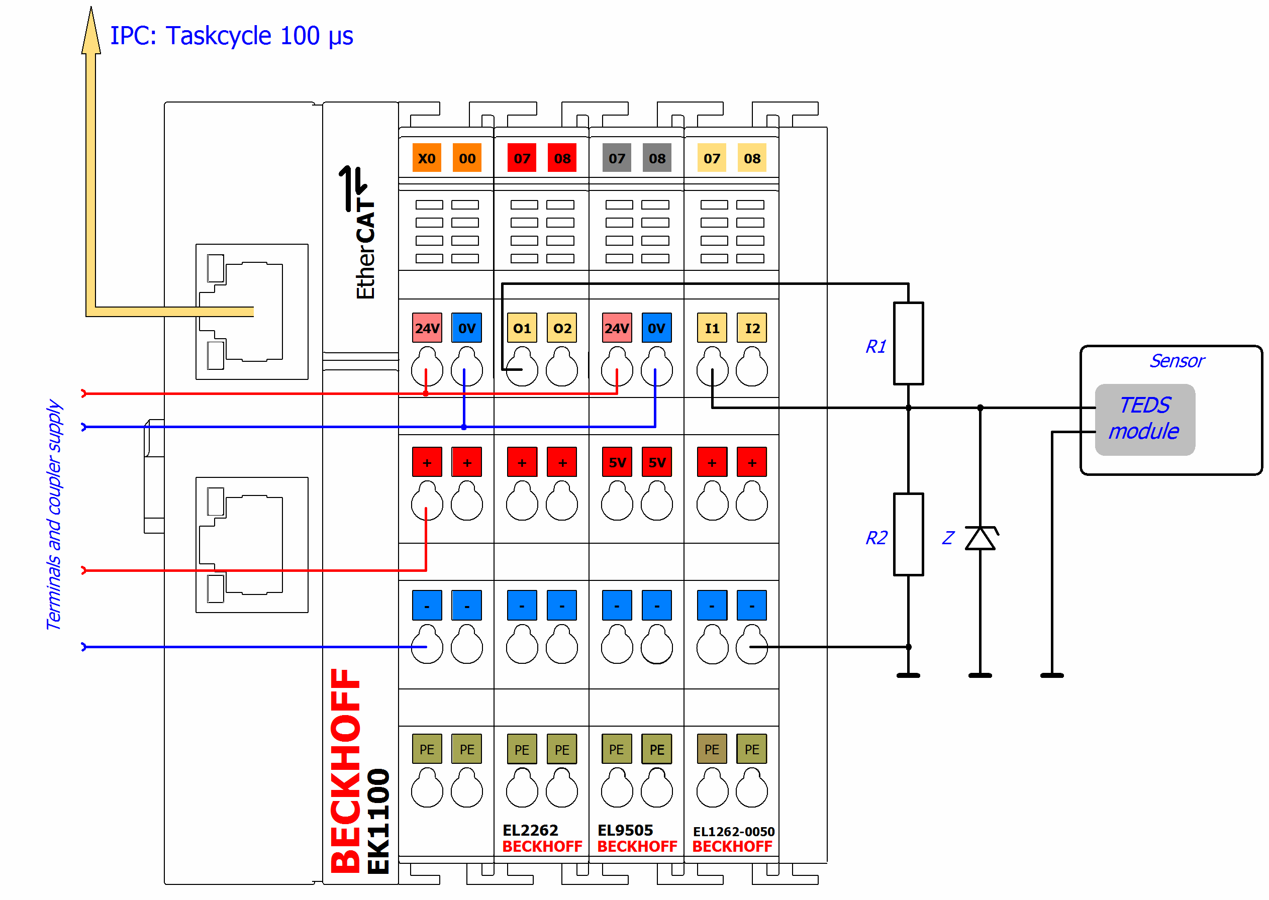

The following configuration is required:
[EK1100] + [EL2262] + [EL9505] + [EL1262-0050] + EL9011
The configuration can control 2 TEDS modules. Only single-channel operation is shown in the example.
Example program 3: Access to TEDS with EL1262-0050 and EL2262 4:Fig.222: Wiring for sample program 3
The voltage divider can be dimensioned with R1 = 2180 Ω (e.g. 680 Ω + 1500 Ω), R2 = 680 Ω and Z = 5.1 V for example.

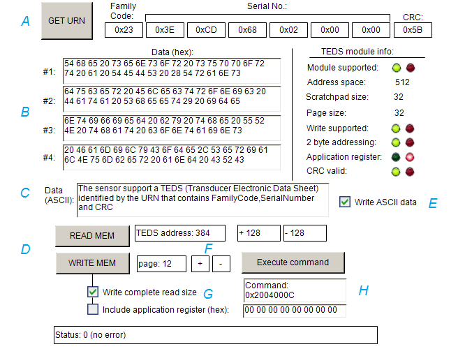

Notes on the program (visualization)
First the URN has to be read (A). Only then are further functions available.
The program determines the URN for each bit by reinitializing the module, since the terminal for the input causes a time offset that is too large (see "Bit repeat count" at the top right).
Data can be written either by entering hexadecimal values (B) or a text string (ASCII) (C); hexadecimal values must be separated by spaces in the text field. Which of the two inputs is to be used for writing can be specified with the checkbox “Write ASCII data” (E):
Example program 3: Access to TEDS with EL1262-0050 and EL2262 5:Fig.223: Visualization of the sample program for TEDS with EL1262-0050 and EL2262
The basic function after the identified URN is (D) reading (READ MEM) and writing (WRITE MEM) TEDS data. By issuing such a command, the associated command statement is generated in the text field (H) and can also be changed and then executed with "Execute command". Via +/- the TEDS address or page can be changed (F). Both the start address and "page" can be entered directly for read / write accesses.
The hexadecimal data (B) of text field #1 to #4 each represent 32 bytes of the total read/write buffer size of 128 bytes, as configured in the sample program. If the checkbox “Complete read size” (G) is unchecked, only text field #1 will be used for writing usually (except the module supports page sizes > 32 byte). Accordingly, only the first characters of the ASCII data text will be written. In any case, the number of bytes as a page of the TEDS module is configured will be used. Note, that the module usually supports write access to addresses of a multiple value of the page size only. For example, assuming a page size of 32 bytes and the address 234 is input, an error 0x35 ‘writing fail’ will occur by a WRITE MEM command; but if address 352 is used, this is valid and there is no error).
Selection of “Include application register” provides whether the application register shall be written or read additionally (G).
