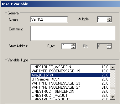

The array variable required for Scope2 can alternatively be defined and created manually in the System Manager.
TwinCAT 2 procedure 4:Fig.165: Add Variable Type

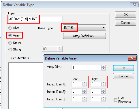

As before in the program (POU "Main"), an ARRAY variable of the same type as from the oversampling PDO of the respective terminal/box must be created. In this example an array of 0..9 of the type INT, i.e. with 10 fields.
TwinCAT 2 procedure 5:Fig.166: Definition of the variable type

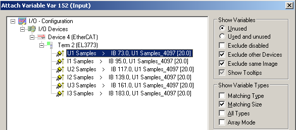

In this example the variable Var152 is created. It can now be linked with the PDO-Array of the respective channel of the terminal/box.
TwinCAT 2 procedure 7:Fig.168: Linking
If MatchingSize is activated in the dialog, the individual channels are offered directly.
TwinCAT 2 procedure 8:Fig.169: Array variables of an oversampling terminal

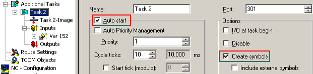

So that the variables can also be found via ADS in the Scope2, the ADS symbols must be activated as well as the Enable Auto-Start, otherwise the task will not run automatically. ADS symbol tables are then created for all variables that have this task in their process data images.
TwinCAT 2 procedure 9:Fig.170: Settings in the additional task

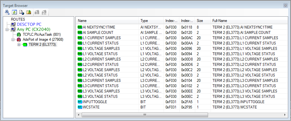

So that the linking works, an array variable with the channel data of the respective terminal/box must be present in the system manager; i.e. each oversampling data package must be present in an array. This array variable must be defined and created manually; see above.

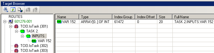

You can now browse to the variable concerned in the Scope2.
TwinCAT 2 procedure 10:Fig.171: Variable browser up to the array VAR152

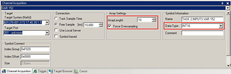

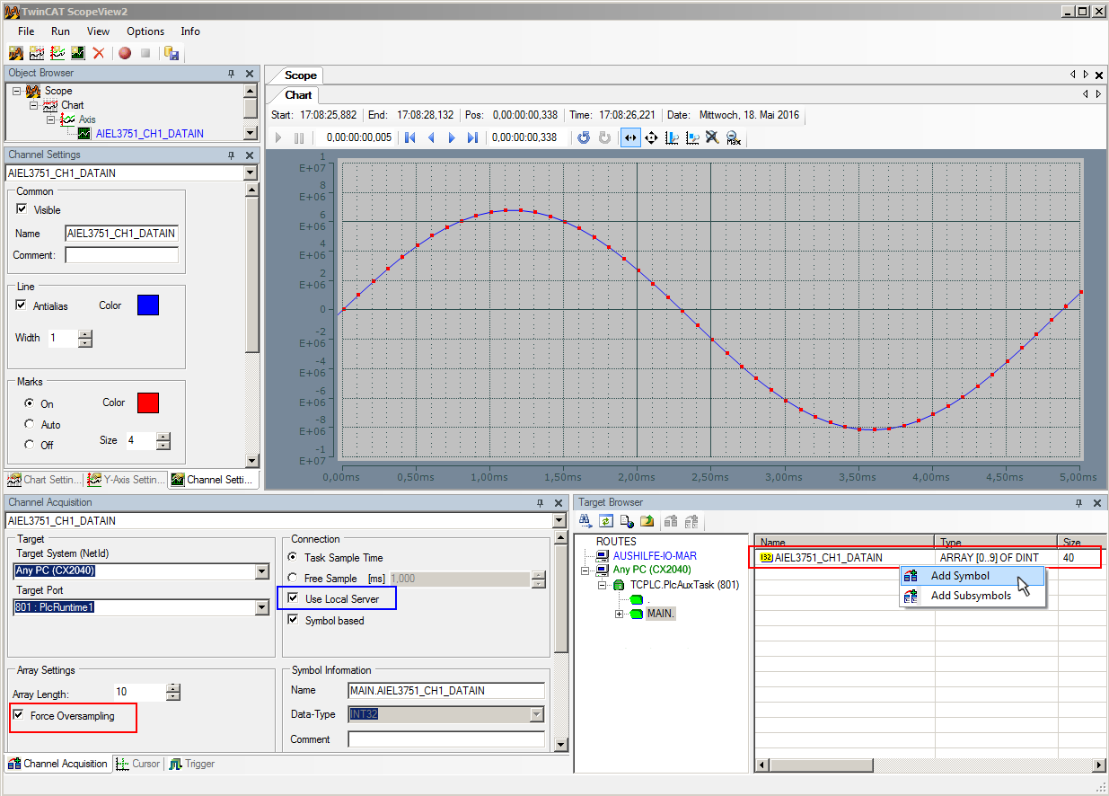

ForceOversampling and DataType INT16 must be set in the channel which has now been created. If necessary SymbolBased must be temporarily deactivated in addition.
TwinCAT 2 procedure 12:Fig.173: Channel settings

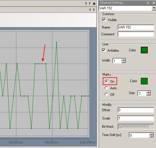

In order to check that individual oversampling values are really being logged, the Marks can be activated in the Scope2. Please observe the interrelationships between task cycle time, sampling time of the Scope2 channel and oversampling factor.
TwinCAT 2 procedure 13:Fig.174: Activation of the marks
An additional example illustrates the following image by representation of an oversampling – variable from the EL3751 with 10 x oversampling:
TwinCAT 2 procedure 14:Fig.175: Illustration of a 10 x oversampling variable of the EL3751 by the Scope2
Within the image was marked subsequently that the oversampling variable originated by the PLC was just added to the Y-axis (observe selection of the PLC-POU name “MAIN” within the “ROUTES” tree). Herewith “Force Oversampling“ was activated due to the oversampling variable is not provided by the terminal/box.

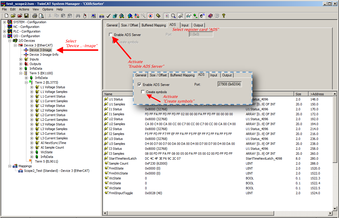

In former TwinCAT 2 versions (or a lower revision as specified in the table above) the oversampling PDO of the respective oversampling able terminal/box can be made visible for the Scope2 by activation of the ADS server.
So, the creation of a PLC variable can be disclaimed as well. Therefore, the ADS server of the EtherCAT Device where the oversampling able terminal/box is connected with have to be activated.
TwinCAT 2 procedure 15:Fig.176: Activation of the ADS server of the EtherCAT Device (TwinCAT 2)
The activation of the ADS server have to be carried out by selection of the “Device – Image” on the left sided configuration tree:
„I/O – Configuration → I/O Devices → Device .. (EtherCAT) → Device .. – Image“.
Next the register card “ADS” have to be selected to activate each checkbox „Enable ADS Server“ and „Create symbols“ then (the port entry is done automatically).
Thus, with the Scope2 process data can be accessed via the target browser without an embedded POU and without a variable reference respectively.
TwinCAT 2 procedure 16:Fig.177: Direct access of the Scope2 to the terminal's PDOs

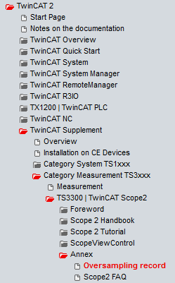

Also see Beckhoff Information System
infosys.beckhoff.com → TwinCAT 2 → TwinCAT Supplement → Category Measurement TS3xxx → TS3300 | TwinCAT Scope 2 → Annex → Oversampling record:

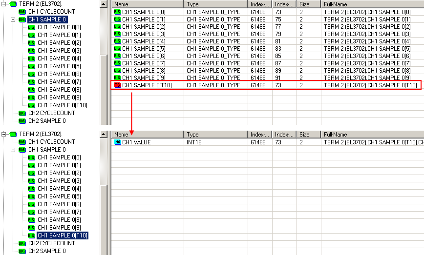

Beckhoff TwinCAT supports the Scope2 with some oversampling devices in a special way by automatically calculating a special ADS array symbol in the background, which appears in the Scope2 in the variable browser. This can be then linked as a variable and automatically brings along the array information.
TwinCAT 2 procedure 19:Fig.178: Automatically calculated array variable (red) in the Scope2
