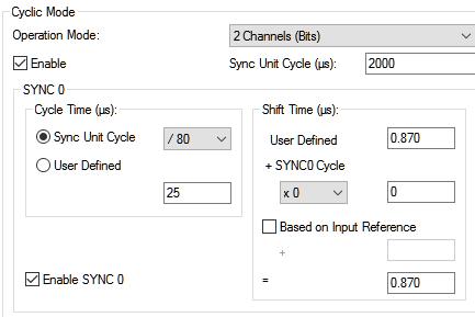

Enter the desired value for "For Outputs" in the EtherCAT master dialog: - - For the individual terminal:
Fig.201: Change SYNC shift time"User Defined ShiftTime" for SYNC0 in [µs] with (decimal values possible) change as required -> this has a direct effect on the read time, i.e. the start of sample = and thus the value in PDO StartTimeNextLatch-
Fig.203: Change User Defined Shift time- If external delays are to be compensated, C0E x80n0:02 "Timestamp correction" can also be written in [ns], in which case the value in PDO StartTimeNextLatch is offset (added or subtracted) against this entry in each cycle . The electrical read time does not change, only the transmitted timestamp is manipulated.
