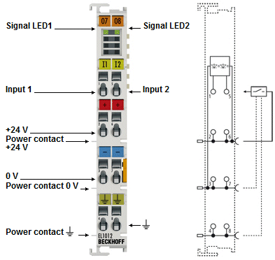

EL1012, EL1014, EL1018 - Introduction
EL1012, EL1014, EL1018 - Introduction 1:Fig.10: EL1012
EL1012, EL1014, EL1018 - Introduction 2:Fig.11: EL1014
EL1012, EL1014, EL1018 - Introduction 3:Fig.12: EL1018
Two-, four- and eight-channel digital input terminals 24 VDC, 10 µs input filter
The EL101x digital input terminals acquire binary control signals from the process level and transmit them, in an electrically isolated form, to the higher-level automation device. They differ in the number of channels and the pin assignment. The digital input terminals of the EL101x series feature an input filter (10 µs) and indicate their signal state through an LED for each channel.
