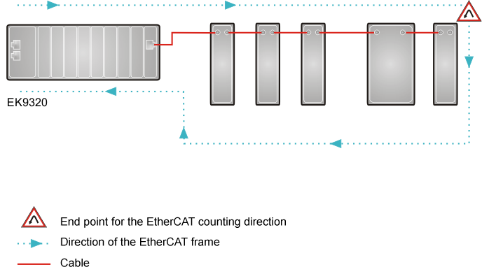

EtherCAT topology
All EtherCAT devices must be entered in the order in which they map themselves on the EK9320 and thus on the EtherCAT master. EtherCAT devices are addressed automatically; with a few exceptions all EtherCAT Bus Terminals are equipped with an EtherCAT ASIC, which has to be entered in the system, i.e. the PROFINET controller. EtherCAT Terminals without an ASIC are, for example, EL9400, EL9070 and other EL9xxx. You can identify these EtherCAT Terminals using the technical data "Message to E-bus". If there is a “-” here, this terminal does not have to be entered in the PROFINET controller.
EtherCAT devices are registered in the direction of the EtherCAT telegram.

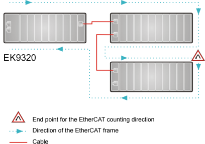

Sample configuration with EK1100 EtherCAT coupler
EK9320 EtherCAT configuration 1:Fig.21: Sample configuration with EK1100 EtherCAT coupler
Sample configuration with EPxxxx EtherCAT Box
EK9320 EtherCAT configuration 2:Fig.22: Sample configuration with EPxxxx EtherCAT Box

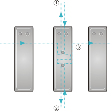

Sample configuration with EP1122 2-port EtherCAT junction
The counting direction is to be observed when using an EP1122; it is comparable with the EK1122. If EtherCAT junction 1 on the EP1122 is connected, then the EtherCAT frame is forwarded here first (1); if junction 1 is not connected the frame on junction 2 is sent (2), only after that does the sequence continue with the EC-bus on the right-hand side (3).
EK9320 EtherCAT configuration 3:Fig.23: Sample configuration with EP1122 2-port EtherCAT junction
If both junctions are not used, then junction 1 and 2 are short-circuited as it were and the EC frame continues directly from the terminal to the right.
It must be noted that in the PROFINET controller the modules are entered in the direction of the EtherCAT frame.
EK9320 EtherCAT configuration 4:
