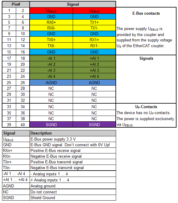

Connection
Connection 1:
The PCB footprint can be downloaded from the Beckhoff homepage.
Notice
Connection 2:
Damage may result!
Connection 3:
Current carrying capacity of the input contacts
The maximum permitted current on the signal-relevant pins (inputs, GND) is 40 mA (if applicable).
Connection 4:
Overcurrent protection of the 20 mA inputs
The current inputs are protected against damage by overcurrent by an internal current limitation, currents > 30 mA may occur. In the event of a fault, the current limiter must not be overloaded by a voltage > 30 V from the source device.
Overcurrent is displayed in the process image as "Overrange".
  • After occurrence, the error condition must be stopped immediately, the source device switched off or disconnected from the input module. If the error condition persists for a longer period of time, the internal module current limitation reduces the absorbed signal current for thermal reasons, depending on the ambient conditions also below 20 mA.
