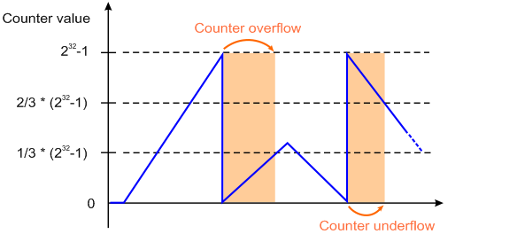

Determining the counter limits (Reset counter value / Limit counter value)
Counter limits in delivery state
In delivery state the counter value “Counter Value” counts in the range from 0 to the maximum counter depth. When the maximum counter depth is exceeded “Counter overflow” the counter starts counting up from zero again. When the counter limit is exceeded, this is indicated by the “Counter overflow” bits (see chapter “Determining the counter limits (“Reset counter value”/“Limit counter value”)”).
When a counter underflow occurs, the count continues at the maximum counter depth even if e.g. “Enable extern reset” is enabled in index 0x80n0:02. The underflow is identified with the corresponding “Counter underflow” bit.
Determining the counter limits (Reset counter value / Limit counter value) 1:
Fig.33: Counter overflow and underflow in delivery state

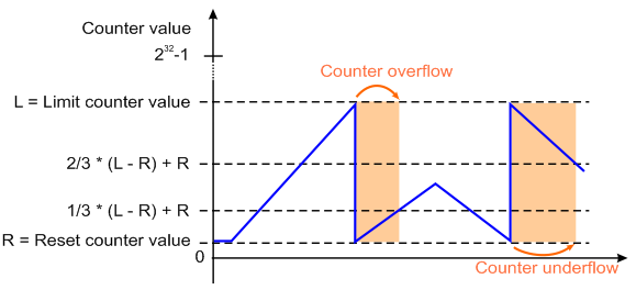

Counter limits with defined value range
If counting is only to take place in a defined value range, the counter limits can be adjusted.
Determining the counter limits (Reset counter value / Limit counter value) 2:
Set counter limits
For writing to index 0x80n1:1B “Reset counter value” and index 0x80n1:1A “Limit counter value”, the value 0x72657375 (ASCII: “user”) must be set in 0xF008 “Code word”.
Determining the counter limits (Reset counter value / Limit counter value) 3:
Fig.34: Counter overflow and underflow with defined value range
Determining the counter limits (Reset counter value / Limit counter value) 4:
Counter limits
  • The lower counter limit index 0x80n1:1B “Reset counter value” must always be less than the upper counter limit 0x80n1:1A “Limit counter value”.
    If this is not the case, the last value entered is not accepted.
  • If the lower counter limit in index 0x80n1:1B “Reset counter value” is greater than 0, the Motion Control application (NC/CNC) can only be used in a limited range.
If the counter is parameterized to a counter value outside the counter limits during runtime, this counter value is applied. Exceeding the counter limit is indicated by the process data “Counter value out of range” (index 0x60n2:15).

Counter overflow and Counter underflow
An overflow or underflow of the counter limits is indicated by the process data “Counter underflow” (0x60n0:04) or “Counter overflow” (0x60n0:05).
Example 1:
0x80n1:1A “Limit counter value” = 212 – 1 = 4095
0x80n1:1B “Reset counter value” = 0
The “Counter underflow” bit is reset when: 2/3 × 4095 = 2730 is reached.
The “Counter overflow” bit is reset when: 1/3 × 4095 = 1365 is reached.
Example 2:
0x80n1:1B “Reset counter value” = 400
The “Counter underflow” bit is reset when: 2/3 × (4095 - 400) + 400 = 2463 is reached.
The “Counter overflow” bit is reset when: 1/3 × (4095 - 400) + 400 = 1632 is reached.
