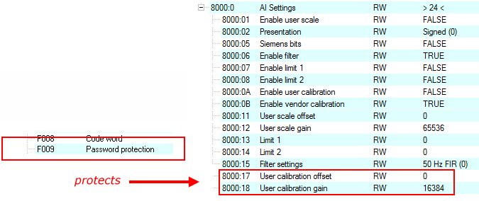

Password protection for user data
Some user data are protected against unwanted or inadvertent writing by an additional password to be entered in CoE 0xF009:
- CoE write accesses by the user, PLC, or startup entries in Single or CompleteAccess mode
- Overwrite the values by RestoreDefaultParameter Access to 0x80n0 (or 0x80nD, if available)
Use of CoE 0xF009
- Entering 0x12345678 enables the password protection → Object shows “1” (enabled)
Protected objects can now no longer be changed, no error message occurs during a write access! - Entering 0x11223344 disables password protection → Object displays “0” (disabled)
Password protection takes effect with the following AI settings:
Index (hex) | Name |
80n0:0A | Enable User Calibration |
80n0:0B | Enable Vendor Calibration |
80n0:17 | User Calibration Offset |
80n0:18 | User Calibration Gain |
80nC | User Calibration Data |
80nD:17 | Low Range Error |
80nD:18 | High Range Error |
80nD:27 | Low Range Error (REAL32) |
80nD:28 | High Range Error (REAL32) |
