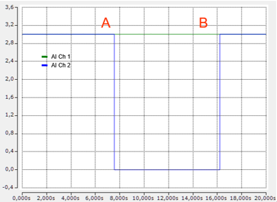

Tare 8:Fig.40: Example: 3 V are electrically connected to Ch1+2 of an EL4374 at the same time, Filter1 = IIR8
At (A), Control.Tare = 1 is set on channel 2 (and the bit is then reset), the tare value is displayed in the CoE:
Tare 9:Fig.41: Tare Value
As expected, the measured value goes to ~0.
At (B), tare is deleted again by command. Channel 1 runs without tare for comparison.
