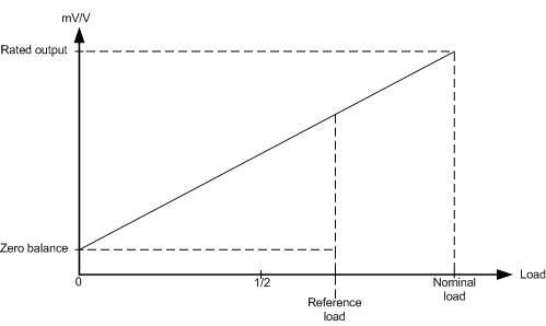

Sensor calibration
The sensor calibration adjusts the device to the characteristic curve of the sensor element. Two values are required for this procedure: the output value without a load (‘zero balance’) and fully loaded (‘rated output’). These values can be determined by a calibration protocol or by a calibration using calibration weights.
Fig.70: Adaptation to the sensor curve![]() | Calibration The calibration is of great importance for the accuracy of the system. In order to increase this, the filter should be set as strong as possible over the entire calibration phase. It may take several seconds before a static value is obtained. |

Adjustment in the system
In the "practical" calibration, measurement takes place first with the scales unloaded, then with a defined load on the scales. The device automatically calculates the existing sensor characteristic values from the measured values.
To do this, follow the procedure below. The adjustment is channel-specific (n = 3 (Ch. 1), n = 7 (Ch. 2).

- Gain adjustment: Apply a reference load to the balance.
- The reference weight should be at least 20 % of the nominal load. The larger the reference load, the better the sensor values can be calculated.
- In object 0x80n0:28 ("Reference load"), enter the load in the same unit as the nominal load (0x80n0:24).
