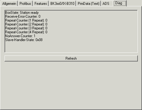

The Diag Tab
The Diag Tab 1:
The following information can be displayed here:
BoxState: The current DpState is displayed here.
Receive-Error-Counter: Number of disturbed telegrams from the slave.
Repeat-Counter: Number of required repetitions due to missing or disturbed response from the slave.
NoAnswer-Counter: Number of telegrams that remained unanswered by the slave.
Last DPV1 error: Error-Decode, Error-Class, Error-Code and Error-Code 2 (see description of the DPV1 Error Codes)
For Beckhoff DP slaves, further diagnostic information will be displayed.
