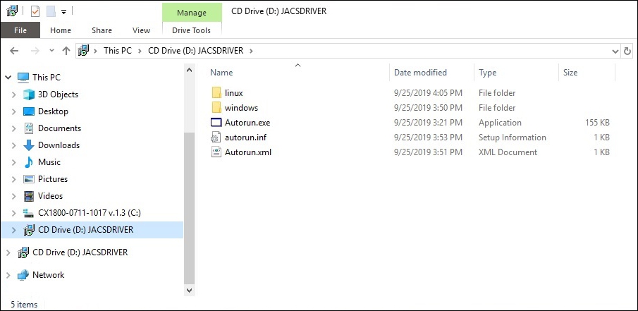

1. Connect the USB stick.
2. The USB stick is recognized as a CD drive.
3. Run the Setup.exe file to start the installation.
Installing the driver 1:

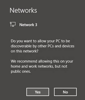

4. After installation, new devices are detected.
Installing the driver 2:

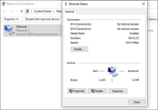

The drivers have been installed successfully if a new network interface appears.
Installing the driver 3:
