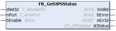

FB_GetUPSStatus
FB_GetUPSStatus 1:
Requirements:
The FB_GetUPSStatus function block reads the status of the UPS hardware from the PLC. The function block is level triggered, which means that the status information of the UPS is only cyclically read while the bEnable input is set. To keep the system load low, the status information is read every ~4.5 s. When the bValid output is set, the most recently read data is valid. The most recent read cycle was, in other words, executed without error. If an error occurs, the read cycle is repeated, and the error signal is automatically reset as soon as the cause of the error (e.g. no communication with the UPS) has been corrected.
FB_GetUPSStatus 2: Inputs
    sNetId   : T_AmsNetId;
    nPort    : T_AmsPort;(* 0 = Windows UPS service / Windows Battery Driver *)
    bEnable  : BOOL;
Type
sNetId
T_AmsNetID
A string with the network address of the TwinCAT computer whose UPS status is to be read can be specified here. For the local computer an empty string may be specified.
nPort
T_AmsPort
The ADS port number. Set this value to zero. Other port numbers are reserved for future applications.
bEnable
The UPS status is read cyclically if this input is set.
FB_GetUPSStatus 3: Outputs
    bValid     :BOOL;
    bError     :BOOL;
    nErrId     :UDINT;
    stStatus   :ST_UPSStatus;
Type
bValid
If this output is set, the data in the ST_UPSStatus structure are valid (no error occurred during the last reading cycle).
This output is set if an error occurred when executing the function.
nErrId
UDINT
Returns the ADS error number or the command-specific error code (table) if the bError output is set.
Error codes
Error description
0x0000
No error
0x8001
UPS configuration error. It is possible that the UPS is not configured correctly or that no UPS is configured at all.
0x8002
Communication error. Communication with the UPS was interrupted.
0x8003
Error during the reading of the status data.
Type
stStatus
ST_UPSStatus
Structure with the status information of the UPS.
Not all UPS devices can provide all status information. Some devices, for example, cannot supply the BatteryLifeTime or BatteryReplace status.

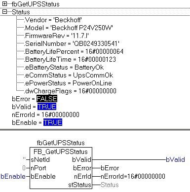

Example:
Online data with status information of a UPS:
