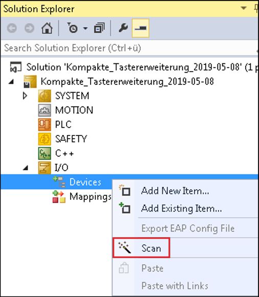

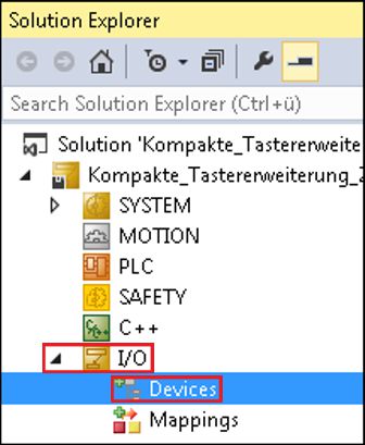

2. Click I/O on the left in the tree view, and then right-click Devices.
TwinCAT System Manager connection 1:Fig.22: XAE Project
3. In the context menu click Scan.

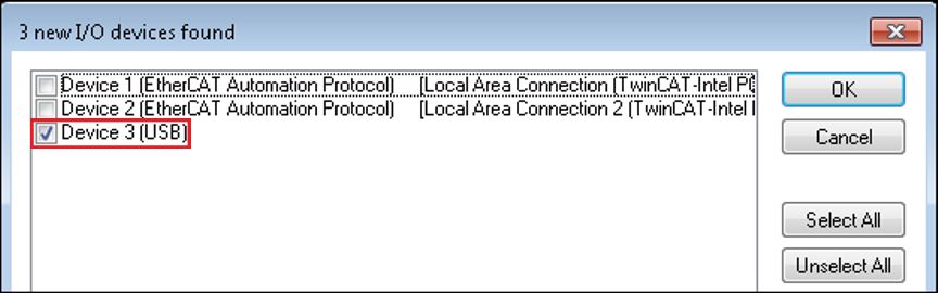

4. Select the devices you want to use and confirm the selection with OK.
TwinCAT System Manager connection 3:Fig.24: Select device

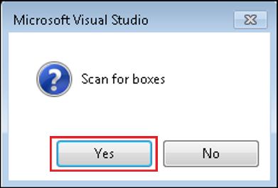

5. Confirm the request with Yes, in order to scan for boxes.
TwinCAT System Manager connection 4:Fig.25: Scan for box modules

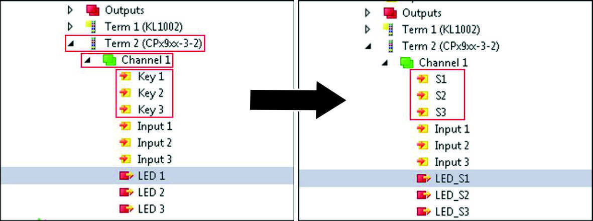

To rename the inputs and outputs, follow the steps below:
1. Click on the arrow to the left of the relevant term.
The associated channels of the term are displayed.
2. Click on the arrow to the left of the corresponding channel.
The corresponding inputs and outputs of the channel are displayed.
3. Right-click on the corresponding input or output.
4. Click on Rename.
5. Enter the function of the input or output from the previous table as the new name.
You have renamed the input or output.
TwinCAT System Manager connection 5:Fig.26: Renaming inputs and outputs
