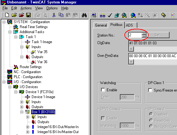

Sample 1: Default Configuration
a.) Open the file
(File). This file contains the System Manager file for the master configuration with the FC310x card and the BX3100 slave. Select the correct PCI address for the FC3101.
and set PROFIBUS address 2 on the BX3100.
Activate the configuration and start the system. The TwinCAT icon (bottom right on the desktop) should be green. The bus LED on the BX3100 should also be green. Should this not be the case, check the BX3100 address and the physical connection with the PROFIBUS master (terminating resistors etc.).
