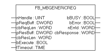

FB_MBGENERICREQ
Function block FB_MBGENERICREQ enables sending and receiving of any ModbusTCP functions. With a rising edge of bExecute the function block becomes active, bBusy is set and the function block sends the data contained in pReqBuff (pointer to the data to be sent). The function block reads the length of the data to be sent from variable cbReqLen. The variable nHandle must be linked to the variable from the function block Fb_MBConnect nHandle. The response from the ModbusTCP server (slave) is stored in pResBuff (pointer to the receive data). The size of the variable should be adequate for receiving all data of a ModbusTCP telegram. If the ModbusClient does not receive a response within tTimeOut, bBusy is set to FALSE and bError is set. Variable nErrId contains the error code. cbResponse contains the number of received bytes. This number can be compared with the buffer size of cdResLen. If cbResponse is greater than dResLen data are lost and a larger buffer should be chosen.
INPUT
   nHandle      : UINT;
   pRecBuff     : DWORD;
   cbReqLen     : WORD;
   pResBuff     : DWORD;
   cbResLen     : WORD;
   bExecute     : BOOL;
   tTimeout     : TIME;
nHandle: Handle, which will be linked to the Fb_MBConnect function blocks.
pReqBuff: Pointer to the data to be sent.
cbReqLen: Length of the data to be sent.
pResBuff: Pointer to the data to be received. The size of the variable must be adequate.
cbResLen: Length of the data to be received. The length must be adequate.
bExecute: A rising edge activates the function block.
tTimeout: Time after which the attempt is aborted.
OUTPUT
   bBusy        : BOOL;
   bError           : BOOL;
   iErrId           : WORD;
   cbResponse   : WORD;
bBusy: This output remains TRUE until execution of the command is complete.
bError: This output is switched to TRUE as soon as an error occurs during the execution of a command. The command-specific error code is contained in iErrorId.
iErrorId: Contains the command-specific error code of the most recently executed command (see table).
cbResponse: Number of bytes that were received.
